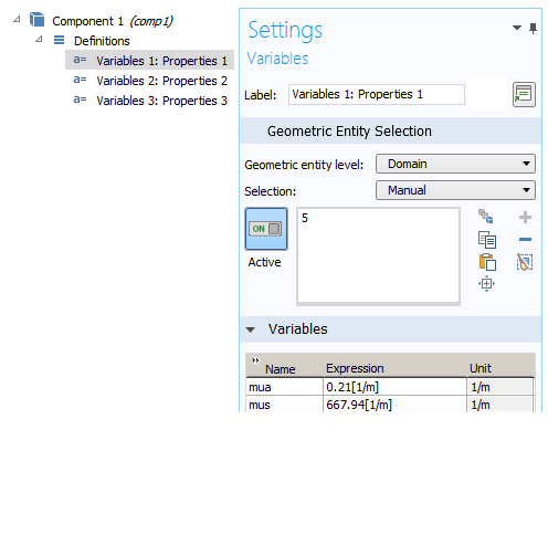

Mateus,
You can use Component/Definition/Variables to assign subromain expressions, as shown in the attached image.
Sergei

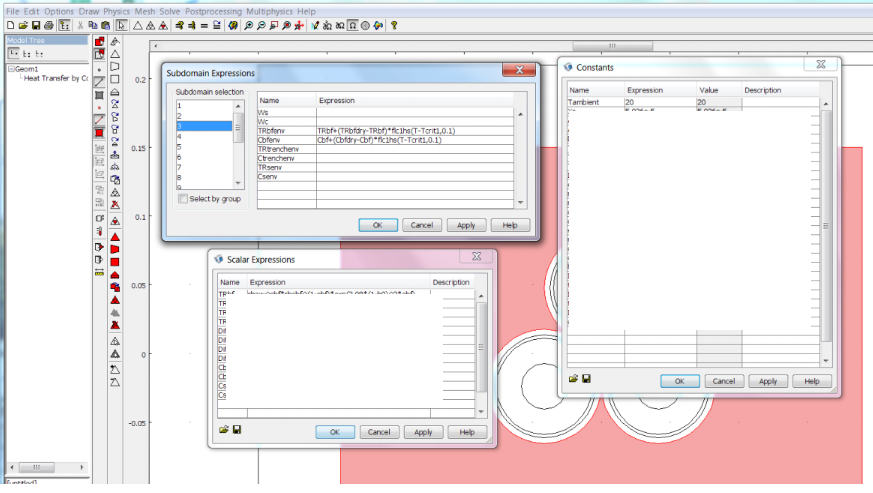

One more question though, do you have any idea how I can refer to the temperature of the domain in this expression? I would like to put in there the following equation: flc1hs(T-5,0.1), where T is the temperature of the selected domain.
Thank you in advance!

Mateusz,
Not sure I understand yous question. If T is dependent variable you are solving for, then it is derectly available in any domain and you can define your variable at the selected domain as var1=flc1hs(T-5,0.1).
Sergei
