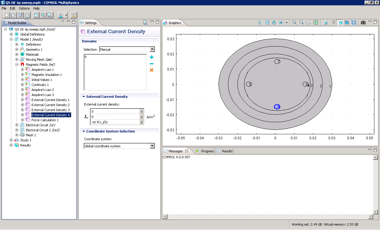

I work with COMSOL 4.0a and I've been having some trouble with the user interface as it gets distorted in the model view after sometimes you use it.
What happens is that the axes scale become different after you use it, then what should be viewed as a circle becomes an ellipse, for example.
Does any of you know where you can manually correct the axis scale, or if there is any automatic way to correct it. Unfortunatelly the zoom extent won't work for this.
The results window, instead isn't affected by this problem.
I could notice that it happens also in COMSOL 4.1.
In attached I put a figure to illustrate what happens. All ellipses in the figure should be circles.
Thanks for any response.

You can lock the aspect ratio through the View node in the Model Builder.

I searched in the model builder using right mouse buttom and clicking everywhere but I couldn't find the View node that you mentioned.
Could you please be more specific about where I can find it?

It's within the Definitions node

That really was the solution of the problem.
