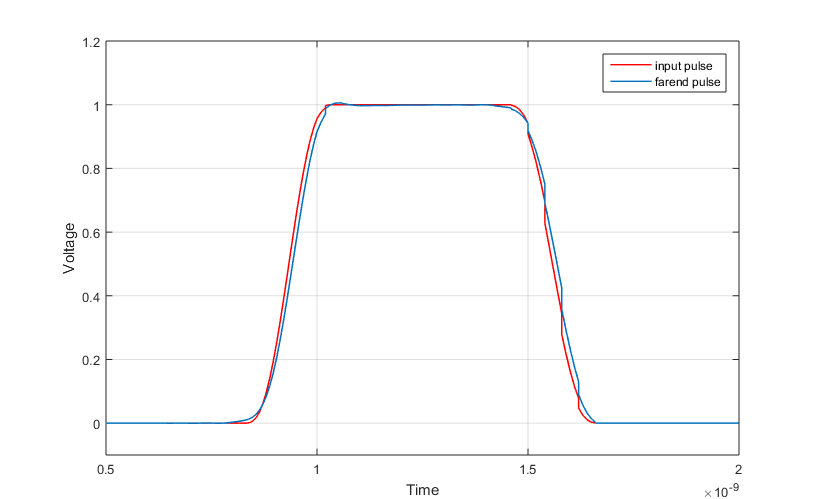

I am new to COMSOL and currently running a very basic simulation that I have many rectangular pulses. I am just wondering how I could to calculate the delay time between these pulses.

you may want to try to calculate the cross correlation and find its maximum.

Thanks for reply, sorry, and hope to bear with me, but i dont have idea about how to do that in comsol and if I do that does it give the time at which moment, as I'm interesting in the delay time of the signal at the 50% and 90% of the rise edge.
