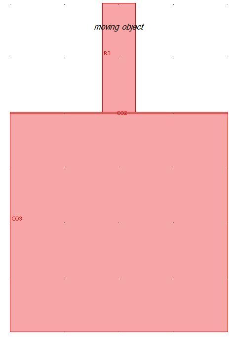

I am trying to build a model of one object that moving with different speeds and come in contact with other object (see attachment), what i want to know How can i model the object to move with different speed and how can figure out the Vonmises stress during the simulation

Hi Ivar, I have the following problem if you can help me: I am trying to build a model of one object that moving with different speeds and come in contact with other object (see attachment), what i want to know How can i model the object to move with different speed and how can figure out the Vonmises stress during the simulation Thanx Ali
