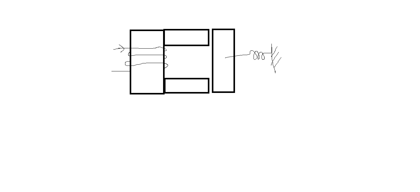

I tried to simulate a structure similar to that of a transformer in which an inductor is wound over a iron core with an iron gap. I have attached the structure image for your perusal. When ever I use stationary solver I dont have any trouble. But coming to Time Dependent solver, I changed the coil nature to Multi-turn coil-Numeric as well as changed the source to Sine source.
I get the following error.
Failed to find consistent initial values. Segregated Step 1 Division by zero. Function: / Failed to evaluate variable. Variable: comp1.mf.mtcd1.Vind, Defined as: (((300comp1.mf.mtcd1.intmtcd(((comp1.mf.mtcd1.eCoilycomp1.mf.Ey)+(comp1.mf.mtcd1.eCoilxcomp1.mf.Ex))+(comp1.mf.mtcd1.eCoilzcomp1.mf.Ez)))comp1.mf.mtcd1.fl)comp1.mf.mtcd1.fA)/comp1.mf.mtcd1.area Failed to evaluate variable. Variable: comp1.mf.VCoil 1, Defined as: (comp1.mf.mtcd1.avemtcd(comp1.cir.IvsU1 i)comp1.mf.mtcd1.R)-comp1.mf.mtcd1.Vind Failed to evaluate variable. Variable: comp1.cir.IvsU1.V, Defined as: comp1.mf.VCoil 1 Failed to evaluate variable. Variable: comp1.cir.IvsU1 vsrc, Defined as: comp1.cir.IvsU1.V Failed to evaluate variable. Variable: comp1.cir.IvsU1 v, Defined as: comp1.cir.IvsU1 vsrc Failed to evaluate variable. Variable: comp1.cir.R1 p v, Defined as: comp1.cir.IvsU1 p v+(-comp1.cir.IvsU1 v) Failed to evaluate expression. Expression: comp1.cir.V1 v+comp1.cir.V1 n v+comp1.cir.R1 Rcomp1.cir.R1 i-comp1.cir.R1 p v Last time step is not converged. - Feature: Time-Dependent Solver 1 (sol1/t1)
Please help me mates. I am in need of this solution.
