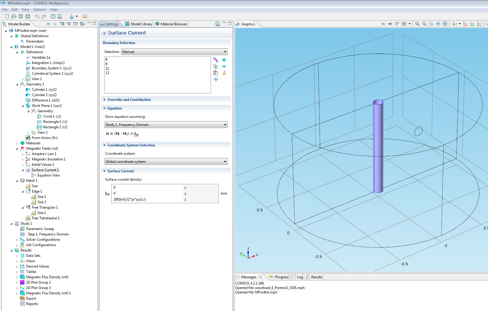

To go into detail my problem is not exactly the same like mentioned in topic. As you can see in the picture 'SpgsInduktionTestSim1.png' I'm feeding-in alternating current in a conductor to check the "induced" current density in a surrounding copper wire. This simulation still works well.
But I'm more interested in a construction like represented in picture 'SpgsInduktionTestSim2.png'. To state more precisely I'm interested in the voltage induced in the coil. As you mentioned, the main problem is certainly the unclosed current circuit of the coil. There arises the question whether it is possible to fix boundary conditions (or something like this) at the 2 coil contacts to get the voltage induced in the coil afterwards.

I'm still busy with the specified problem. As you can see at the attachment I'm interested at the induced voltage between the boundaries (contacts) 15 and 16 of the coil (coil with only 1 winding). I've calculated the solution by hand but I'm not able to get the problem solved in Comsol correctly. I've read lots of topics but I couldn't find a solution how to solve this problem in 3D. As you can see in the file I tried to find a solution by line integration (Eds), but there is still a bug in it
It would be really great if someone could help me.

I have an example hereby in v4.2a it looks reasonable. In frequency domain you need some conductivity in air, its "just" that it must be kept sufficiently small to be realistic, it depends on the frequency to, which is rather obvious from the equations
I did it in MF as it's by far not so heavy to solve as MEF

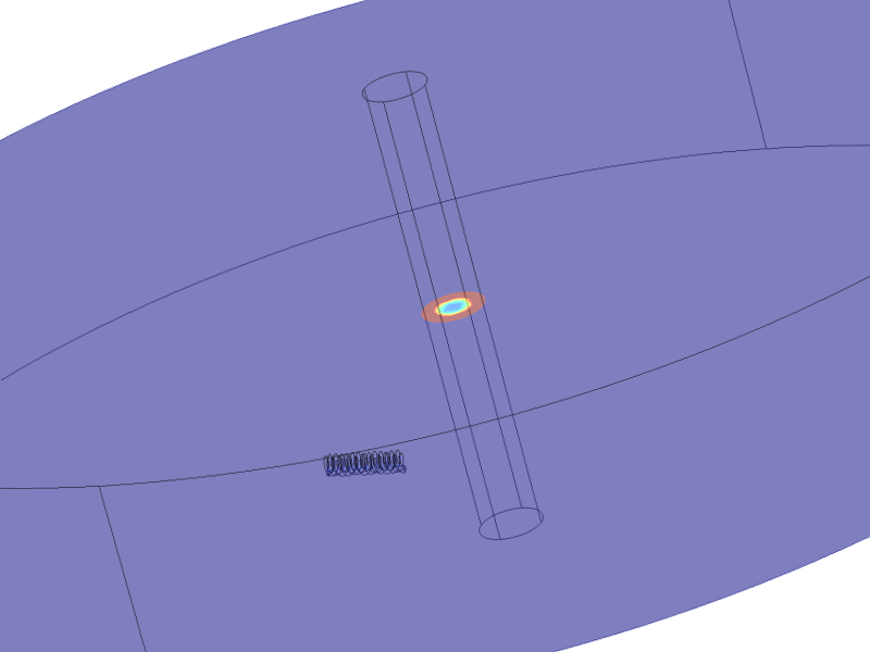

here is an image and the deailed reportyou might manage to redo it from here ;)
first of all let me say thank you for the help.
I've still solved the problem by integrating the flux density over the cross section of the coil and furthermore multiply by 2*pi*f (like in the test example). But it's not really the way like I want to solve the problem.
However, the 2nd approach (Global Evaluation 3) could be more interesting for me. So I've to study this approach in more detail.
Okay, at first sight it seems to be the same approach, only defining a variable EMF first...
Is the only approach to solve this problem in comsol really to solve it with mf? No feasible way to get the induced voltage with emf?
Thank you very much Ivar!

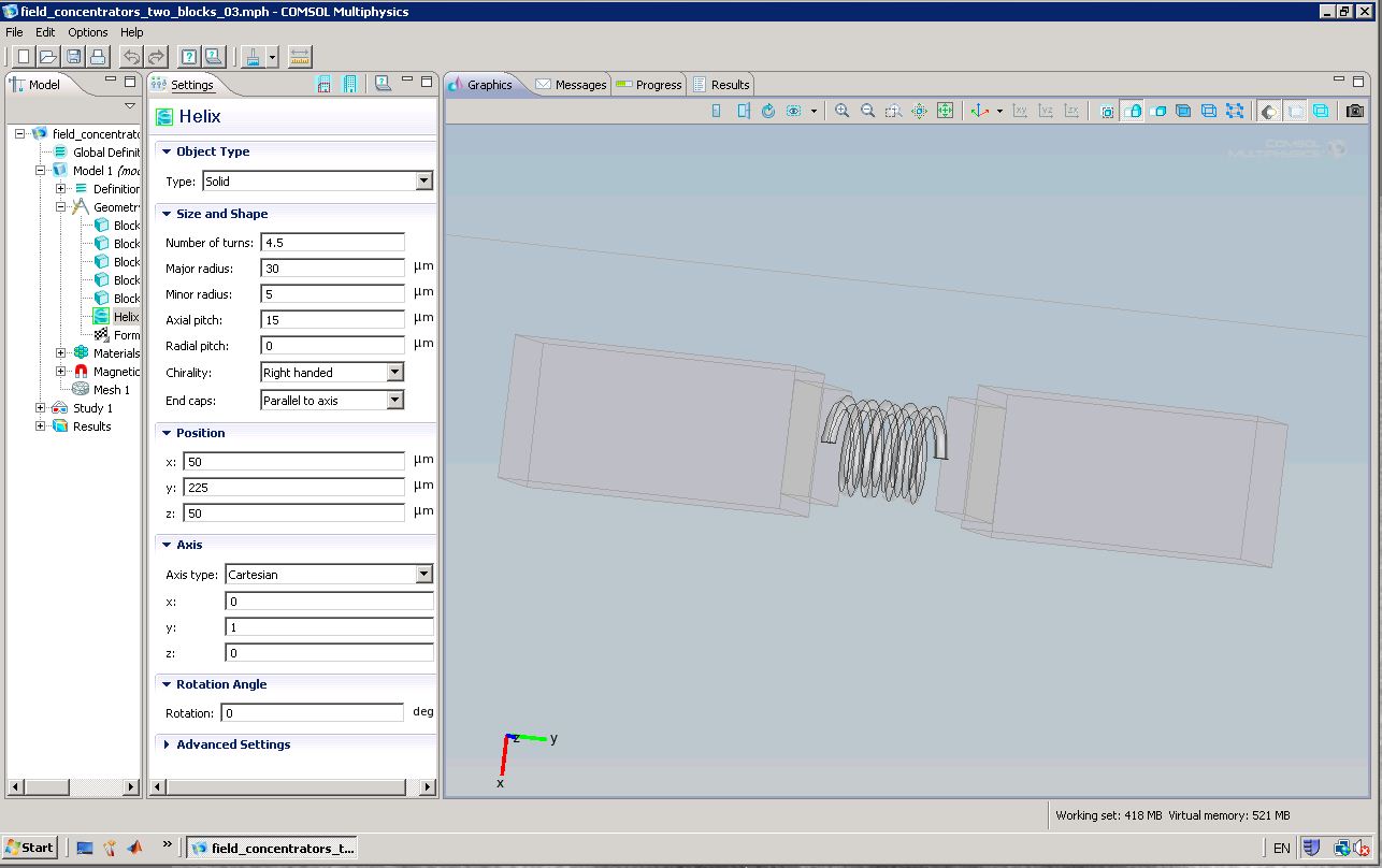

I need documentation of model in which the Inductive coupling between two coils , to find inductances of both coils , magnetic flux density , mutual inductance , coupling coefficient ...
(1) I need to fix the distances between the coils , as distance increases how the various parameters increases ..
Please provide me this documentation
Thanks in advance , waiting for favourable reply
kishore Naik Mude
Indeed I have noticed that is not readily in the model library of 4.2a, you have only single coils. This is something I havent tried in v4 yet, back in v3.5 I know I once integrated all the fields and coil sections to see how this behav w.r.t my ACDC cookbook.
I woulder if it has not been discussed already, have you tried to search the Forum, and the papers, there it must have been discussed, but there might not be a ready model, sometimes yes. And check the Model exchange too
