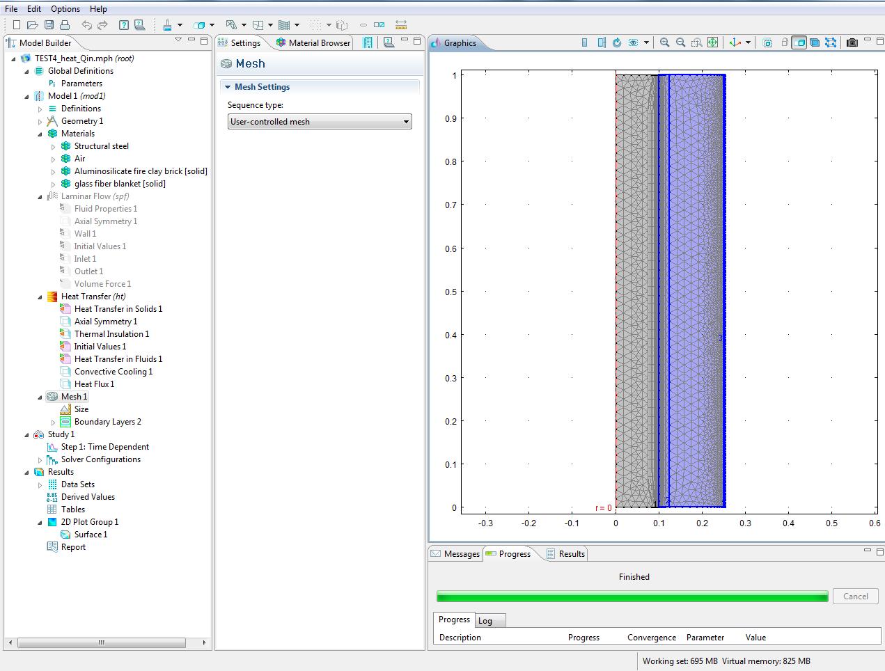

I have a problem that I would like to have solved. It is a relatively simple model in which a stream of air (non-isothermal flow, 873 K) flows through a tube of which the inner layer is made of ceramic material, the next is made of mineral wool and the most outer (thin) layer is made of structural steel (length: 1m).

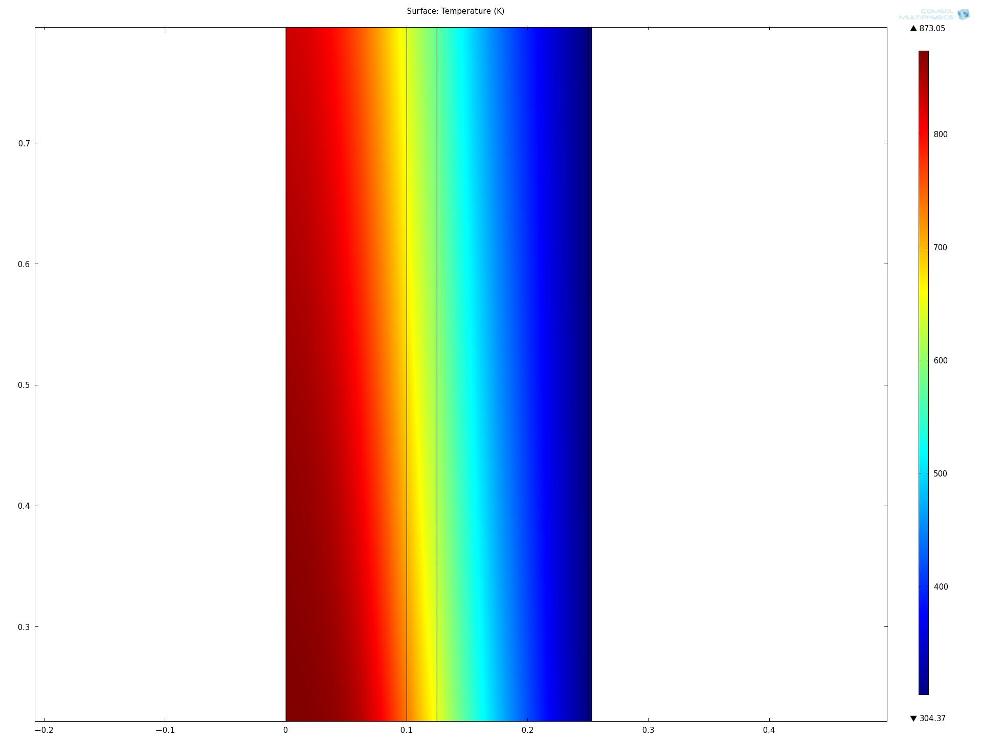

I have done a stationary simulation which gives believable results. The temperature gradient is plotted in the attached 'SteadyState_2D_Axi.jpg'. Now I wanted to make an instationary model as well, to see how the temperature in the solid material changes in time. My idea was that for longer simulation times, the instationary solution would converge to the stationary solution. However, I have been unable to find a good instat. solution at all.
MODEL (stationary version also attached)
Inflow velocity (v_in) : 0.1 m/s
Inflow temperature (defined at inlet boundary) : 873 K
Material properties well defined and green checks for all.
Mesh: Extra Fine with 12 boundary layers on the fluid/solid boundary
Inlet BC : 'Velocity' (normal inflow) : v_in
Outlet BC: 'pressure, no viscous stress', P=0
Solid+fluid pressure P: user defined: 1 atm
Convective cooling at the outside of the model (h=5 W/m2K)
IC: u2:r=0, u2:z=v_in, P2=0, T0=293 K
Ouflow defined at outlet boundary

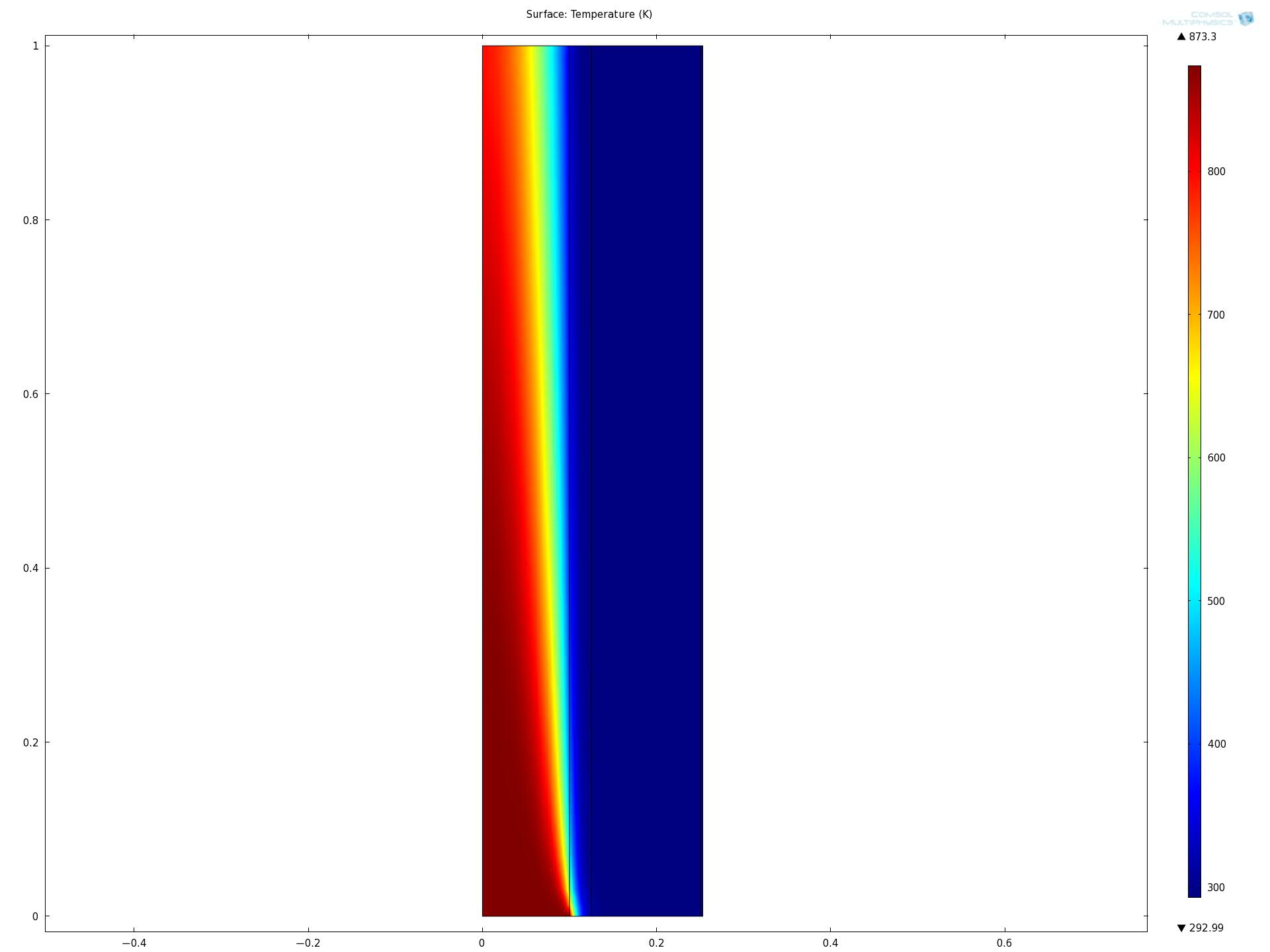

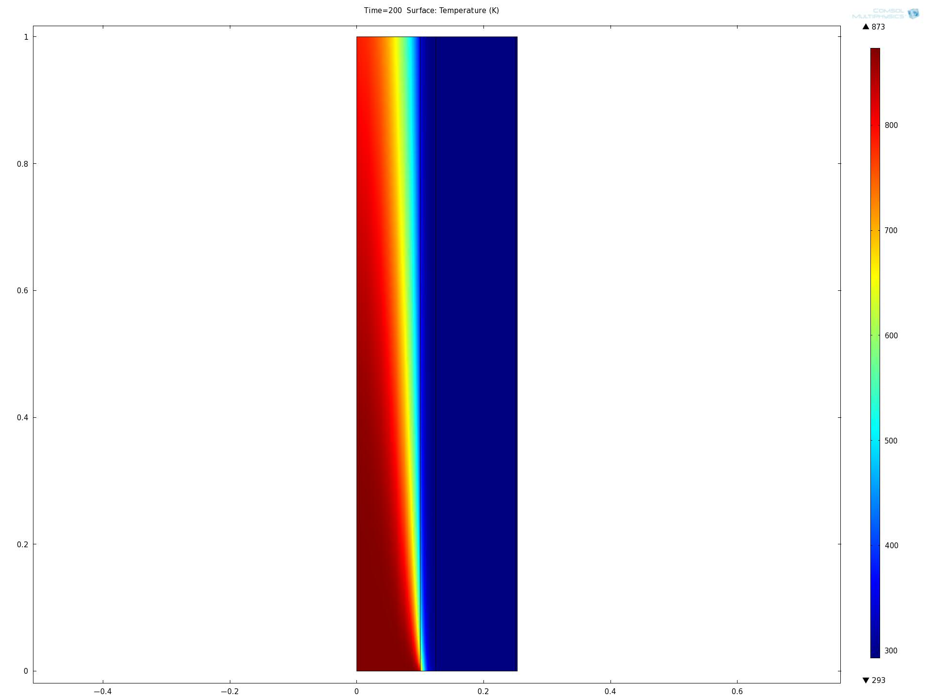

If the exact same settings are used for the instationary calculation, it seems there is no heat flow to the solid matter at all. (see attached picture 'Instationary Wrong Result 1 (time range 0 1 300).jpg') .

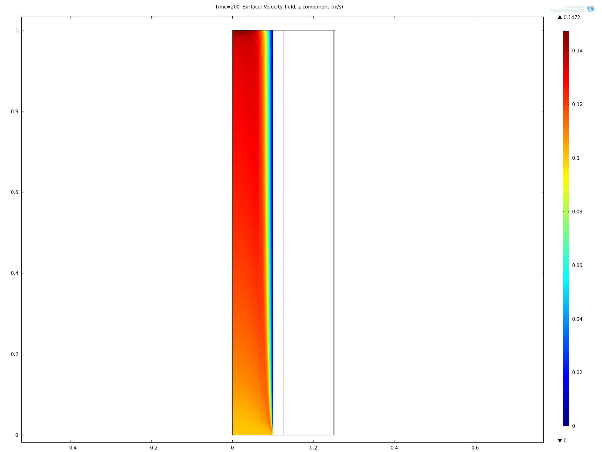

Also, for some settings there is only an extremely small temperature difference at the air-inlet and no difference in temperature in the rest of the model at all, as if there is no flow. This would seem like a pressure problem, partly also because I find the way COMSOL describes pressures a bit difficult to understand. You need a pressure difference to be able to have flow, but I don't know the delta P and I can't define both an inlet pressure AND velocity.
And sometimes it is unclear whether P is P_absolute or P_gauge.
My main questions are: How do I get the instationary model to work? And: Why is it not possible to define an inlet velocity AND pressure? There is also a fluid pressure, but where does this apply, everywhere, including at the inlet/outlet boundaries?
