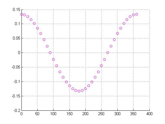

Hi there,
I have already tried this option, though the results are better than the previous attempts but still long way from the analytical results. It is suppose to be a simple 2D electrostatic/DC conductive media problem and even with coarse mesh it should have give accurate results. My model is attached in my previous post, you can check it.
As mentioned earlier, i am using the poisson’s equation capable of handling current sources i.e.
-del.(sigma delV-Je)=Qj
I do not see any problem with the setup.
Point source and sink are assigned 1A/m and -1A/m respectively. The distance between them is very very small, when compared with the radius of the circle.
The boundary of the sphere/circle has electric-insulation boundary condition i.e.
n.J=0 (no current flows across the boundary)
When FD method is used, instead of the FEMlab, with SOR iterative method the result converges to the desired results.
I would be really grateful if you could direct me in the right direction.

Salman, your model is not a 3D sphere, but rather, a 2D cylinder. The cylinder is of radius 0.1 m like you want for the sphere, but it is a depth (or height) of 1.0 m which is the default depth for the model you have chosen. Also, the solution is quite mesh sensitive and required a nonlinear solver to converge. You had it set up using a linear solver, but my guess is that the problem required a bit more work to solve. I like to set the nonlinear solvers for a damping factor initially at 0.1, then multiply by 2.0 to force at least 5 iterations. Also, I looked at the peaks inside your model where the potential points are set which drives the problem. You had a denser mesh there, but I think that should be the focus on whether you converge or not. with the mesh you provided, I looked at linear, quadratic, and cubic element basis and the peak-2-peak values there of about .77, .885, and .94 respectively. So, it is sensitive to the mesh/interpolate resolution, and it is solving the wrong problem. Also, I am using comsol v3.5a, and you mentioned femlab and your file extension is .fl, so perhaps you are using an earlier version that may give different results than what I have.
