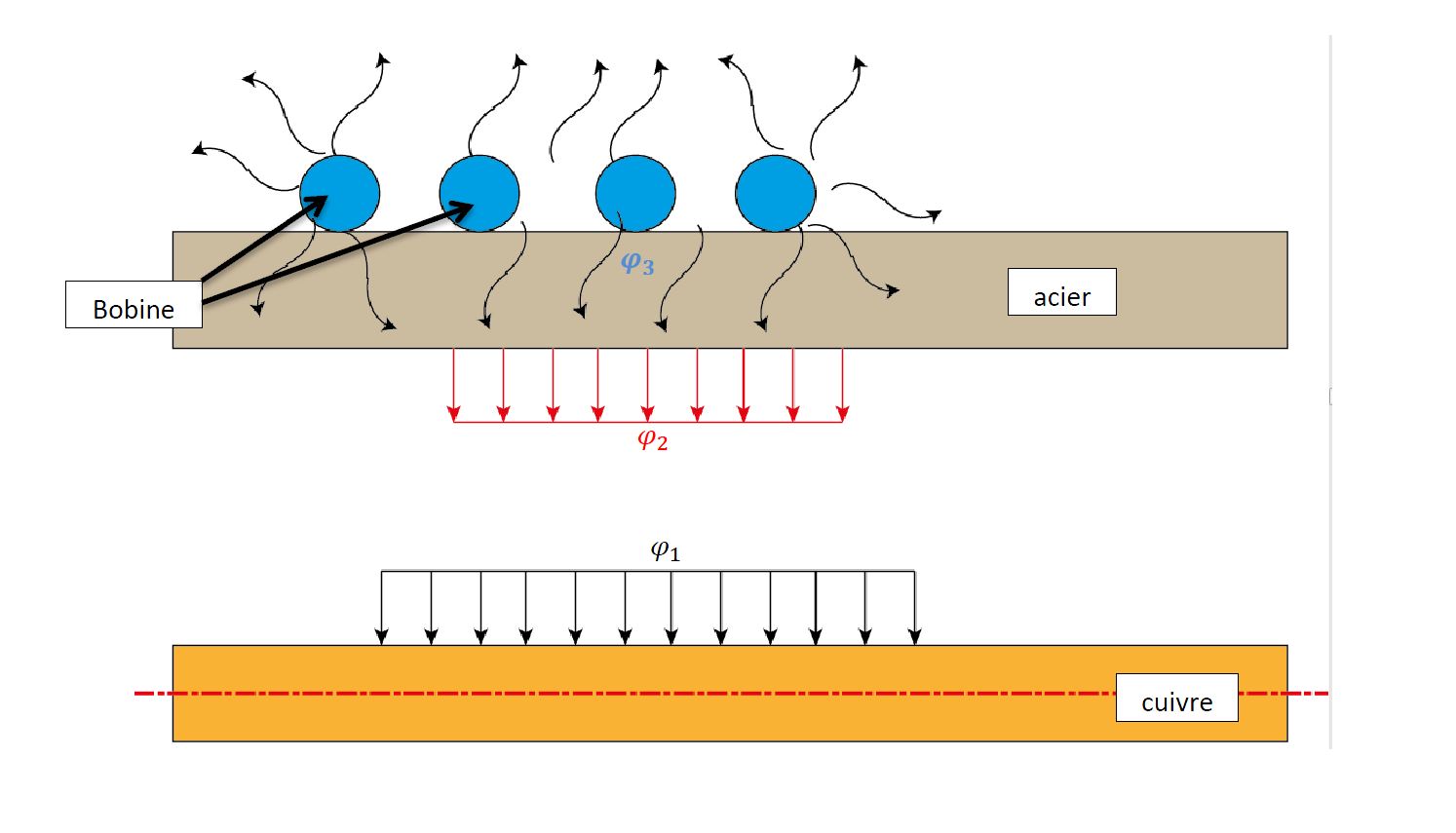

I have to lead a study on an annealing process of a moving copper wire by radiation, and I do not know how to start.
I need a model with an iron tube heated by a resistive solenoid, and this tube will heat the copper wire by radiation. I determined by calculation what should be the heat flux density phi1 to have the copper wire at the right temperature, and I have to know the electic properties (power or tension) I need in my solenoid to respect phi1
It's important to note that the copper wire is moving on x scale, and that between the tube and the wire, there is a flow of gaseous nitrogen for the neutral atmosphere, but it should not interfer a lot in the heat transfert.
Eventually, I would like to have a little help on what modules I have to use, and some of the boundary conditions too. The Figure is attached below.

So far I used "Joule heating module", with surface-by-surface radiations, but i end up with increadibly high temperatures (like a million K) even with a very weak potential difference (0.5 V). I read that from a tutorial "Model the electrically generated heat using the Shell, Conductive Media DC application mode from the AC/DC Module." but I don't know what to do with that (plus there is no way to visualize heat).
Thanks for your help
