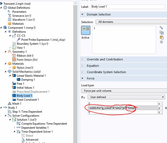

I have a solid mechanics module + time dependent study. How can I apply a sinusoidal time dependent load (to simulate sinusoidal base excitation)?

Hi I am looking for nonlinear (geometric) large deflection response and I think time dependent would be most apt.
I am trying to apply the load (base excitation) as a body force (as shown in the snapshot attacked to my 1st post). Any suggestions?

You can type a mathematical expression like the one in your screenshot, but the variable for time is "t", not "time".
In that case I agree you will need to do time dependent analysis.
Be aware that the system may take a very long time to reach steady state if it is lightly damped. Running a very long time-dependent simulation takes considerable computation time and may diverge.
