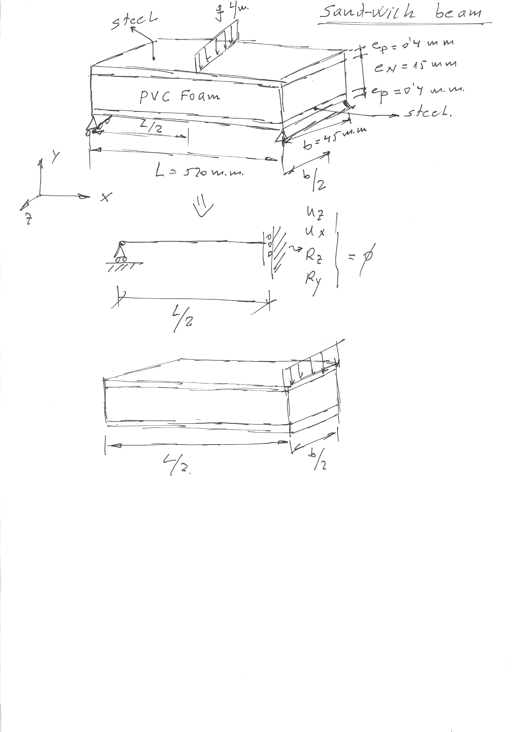

I'm doing my final degree work of mechanical engineer in Málaga university (south of Spain). This is the efect of the shear force in the bending of a sandwitch beam. I mean the effect of tranverse shear strains,neglected in the classical theory (Euler-Bernoulli theories) becomes significant in sandwitch beams.
I have to study by hand calc and by modeling by a FEA software. I have recently done a course in Comsol (30 hours) at the University,but i dont know how mesh and the boundary conditions. I try a lot but the reults are not corrects.I need to use brick elements (hexaedro).
Can you give me some advice?
Please see the attachment file.
