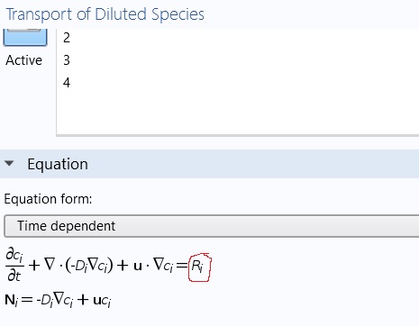

Hello, I am currently doing a research project and I need to modify an equation. I want the 'R' value on the right hand side to be 0.
I have attached a photo with the equation I need to modify.

By default, the right-hand side is 0. It is only if you add a Reaction node and specify a nonzero reaction rate that you will have a reaction in the computed solution (in the domains where the Reaction node is active)
