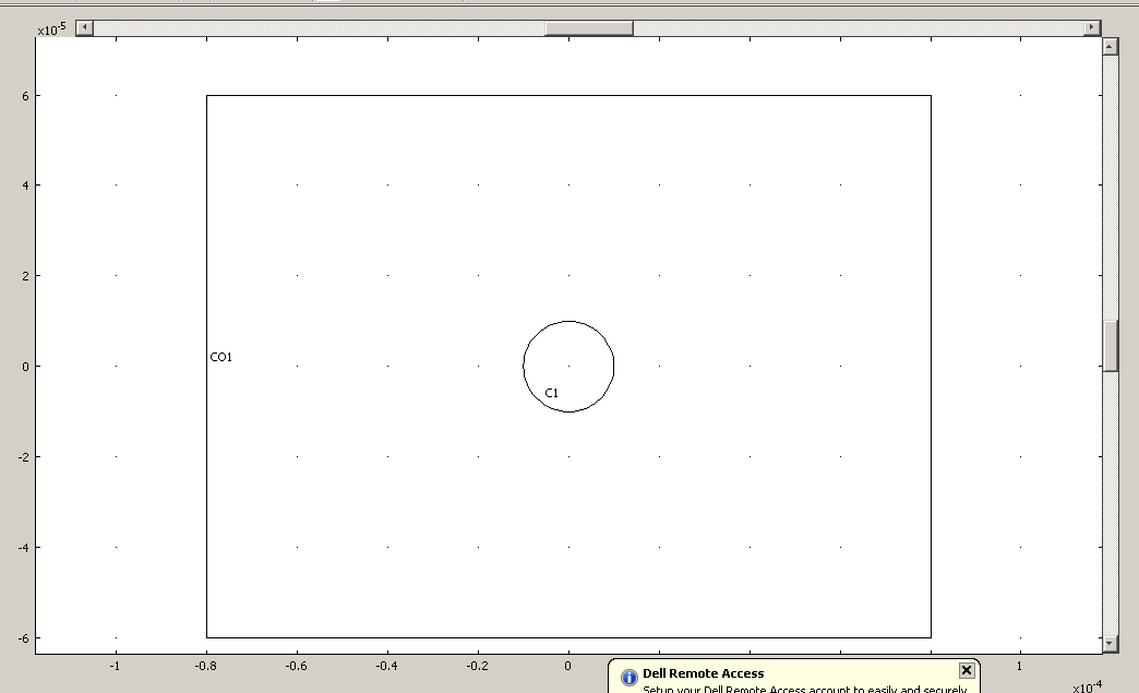

I wish to model a muscle tissue (solid domain) which contains a capillary blood vessel (fluid domain). I’m not interested in the blood flow.
The geometry is in the attached file.

Well, actually I have made some progress since my message was posted. I’ve realized I can change the thickness of the cross section: I’ve changed it to 150 ?m, so now it fits better with my model dimensions (160 ?m *120 ?m). After changing the thickness I found it logical to use the blood pressure value…
As I’m not interested in the blood flow but rather interested in the heat exchange and the load blood exerts on the vessel wall, I’ve decided not to use the fluid application: I’me using the structural mechanics plane strain modulo and bioheat equation from the heat transfer.
