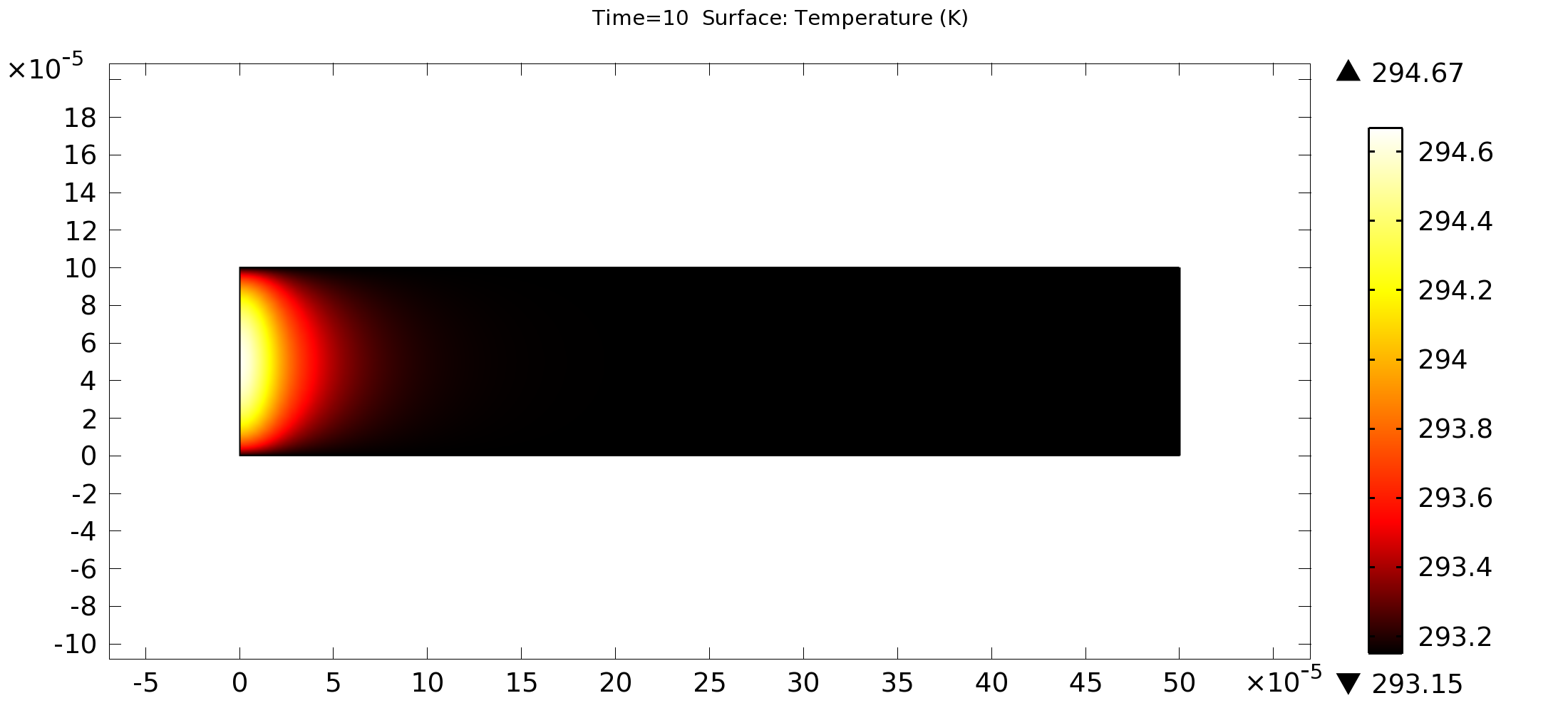

I have added a Heat Source in the Heat Transfer physics. My heat source is a Gaussian beam.
Q = (2*alpha*Po/(pi*r0^2))*exp(-2*(r/r0)^2)
I maintain temperature fixed on the walls of the cell using Temperature (T0=293K). (I have done this because the cell is placed in the thermostat). When I remove it, temperature becomes extremely high.
Velocity is also constant when changing the time.
p.s. I get a distribution of the temperature but it doesn't change with time. Temperature distribution is like a Gaussian distribution. find attached.
From the experiment I know that temperature should gradually rise then it becomes constant after several seconds.

I just deleted all stored data from previous calculations and run program again but it didn't help. I deleted the "Temperature" from the project but it didn't help. Thus the problem is not related with this point. I also changed initial values but it also didn't solve the problem. Have you ever encountered such problem? My project file is very huge (don't know why) and I could't attach it :(
I want to obtain some information about convection induced by Gaussian laser beam. I use two physics, laminar flow and heat transfer. In laminar flow physics I use initial values
velocity = 0 and pressure = rho*g_const*(height of the cell - z)
and
volume force = spf.rho*g_const*betta*(T-T0) , betta = 0.002[1/K]
In heat transfer i just fixed temperature on the walls (T0=293K) and added above-mentioned Gaussian heat source.
Initial temperature is T0.
I just deleted all stored data from previous calculations and run program again but it didn't help. I deleted the "Temperature" from the project but it didn't help. Thus the problem is not related with this point. I also changed initial values but it also didn't solve the problem. Have you ever encountered such problem? My project file is very huge (don't know why) and I could't attach it :( I want to obtain some information about convection induced by Gaussian laser beam. I use two physics, laminar flow and heat transfer. In laminar flow physics I use initial values velocity = 0 and pressure = rho*g_const*(height of the cell - z) and volume force = spf.rho*g_const*betta*(T-T0) , betta = 0.002[1/K] In heat transfer i just fixed temperature on the walls (T0=293K) and added above-mentioned Gaussian heat source. Initial temperature is T0.

I have fixed the temperature on the boundaries, because without that point temperature becomes extremely high.
I also tried to solve this by means of "Inward heat flux", using air thermal conductivity=10 W/m^2/K, but it didn't help. Temperature was so high.
Do you have any suggestions? There is also one point always bothering be. I set initial value for temperature T0=293.5K. After calculation I get T(t=0) = 295K. The same can be said of velocity. I set v(t=0)=0, but after calculation it is about 10^-9. ???
Any help or thought is highly appreciated.
Hi Amir, Thank you for response. I have fixed the temperature on the boundaries, because without that point temperature becomes extremely high. I also tried to solve this by means of "Inward heat flux", using air thermal conductivity=10 W/m^2/K, but it didn't help. Temperature was so high. Do you have any suggestions? There is also one point always bothering be. I set initial value for temperature T0=293.5K. After calculation I get T(t=0) = 295K. The same can be said of velocity. I set v(t=0)=0, but after calculation it is about 10^-9. ??? Any help or thought is highly appreciated.

I have read in the forum that Comsol changes initial values to find a convergent solution for the problem. I think that's the problem why I get other values after solving the problem. But in my problem values of variables are small. That's why I am concerned with the initial value of the velocity after solving the problem. Expected value of the velocity is about 15 um/sec but I get 10^-9 instead. My domain height = 100um=0.0001m and width = 200um, but the with is not playing any role here.
In Heat transfer as an initial value T0=293.5K has been used.
In Laminar flow Velocity(t=0)=0 (both r and z components).
In laminar flow physics I don't have any boundary conditions. There is no such option in this physics as far as I know. In Heat transfer physics I just fixed temperature on the walls.
About time scale. From the experiment it was ascertained that I can solve this problem within 10sec. After 10sec. material becomes isotropic and my calculations become meaningless.
About constant temperature on the walls. I tried to remove it and now I see the evolution of the temperature but It becomes extremely high within the first second. As always, temperature is extremely high - more than 600K.
