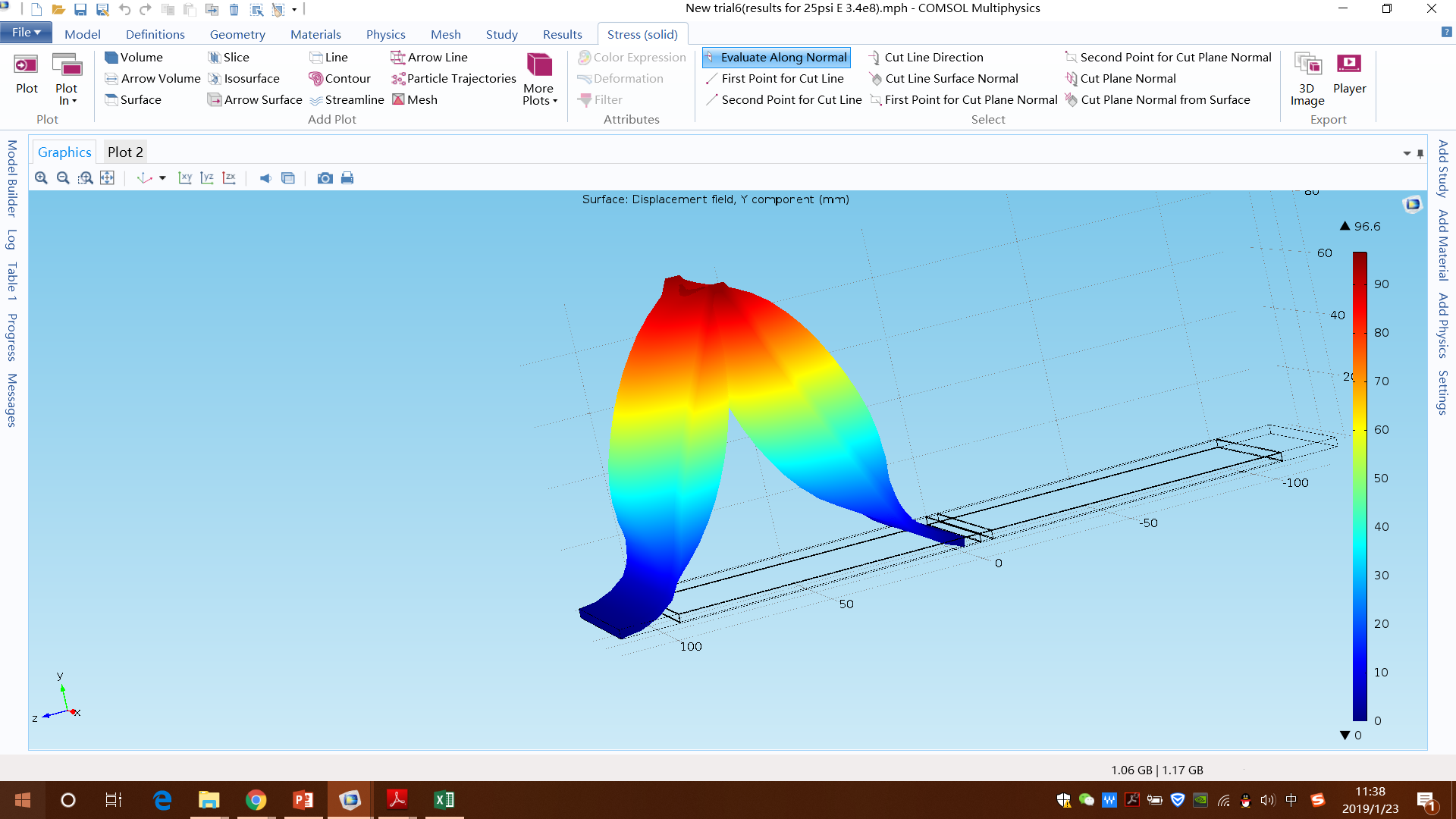

Can I use shell interface instead considering membrane is so hard to converge?
What I am modeling is an airtight cloth with inner pressure inside.
The idea is to set a prescribed distance at its center to get its corresponding reaction force.
I've attached 2 screen shots below.
Thanks in advance, Ke Wu
Thank you so much! Can I use shell interface instead considering membrane is so hard to converge? What I am modeling is an airtight cloth with inner pressure inside. The idea is to set a prescribed distance at its center to get its corresponding reaction force. I've attached 2 screen shots below. Thanks in advance, Ke Wu
Posted: 6 years ago Jan 25, 2019, 2:17 a.m. EST
You can use the Shell interface. The reason not to do that is that as the bending stiffness gets smaller, the numerics gets more and more ill-conditioned. But as long as the solver does not throw warnings or errors at you, a shell solution will work. Due to the bending stiffness there will be no tendency to wrinkling.
