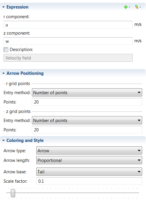

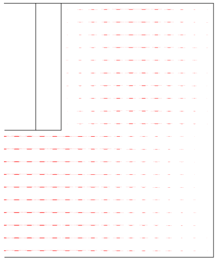

I am having lot of trouble with the arrow plot. I solved laminar flow in a tube and trying to get arrow surface plot. I am using comsol 4.2. Instead of arrows, I am seeing only horizontal lines. Please see the attached screen shots.
Can anybody point out the mistake?

maybe they are arrows but your scale factor is so small that they seem like lines.
hope this helps.
