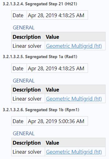

In COMSOL Multiphysics 5.4, I had run two simulations using the Time-dependent Study. In them, the Iterative solver was used. According to the Complete Reports that were written from these simulations, there were three additional Segregated Study steps done in Simulation #2 that were not done in Simulation #1. These additional steps, as they are described in the Complete Report that was written from Simulation #2, is attached to this post as a JPG image ("AdditionalSegregatedStudySteps.JPG").
May you explain how the execution of these three additional Segregated Study steps in the Time-dependent Study affects the results in terms of their accuracy?
