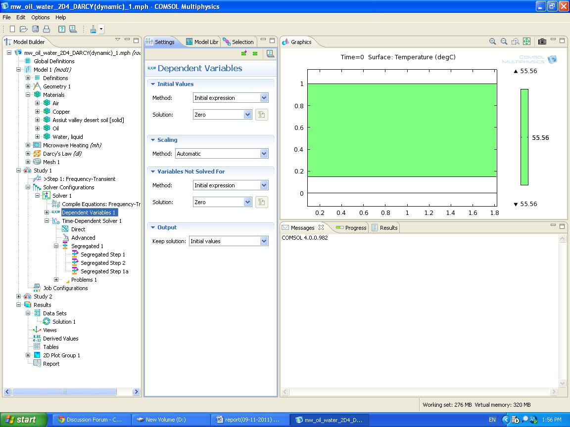

Please have a look on the attached image and let me know in which section of the solver I can define use of only specified results?
Many Thanks in advance!
Thanks Ivar for your response, I think that the model is not huge in my case as I am just using the dynamic properties of fluid defined as interpolation function at different temperatures. Microwaves heating is coupled with Darcy's flow for this model, total file size of the COMSOL file for this model is just 450 Kb. I think it makes sense that it would be storing many intermediate results, how can I check that? Regarding your statement " Check if you have ticked "all" or only specified results in the solver node", I am not sure how to check and define specified results in the solver as I did not see any option addressing this issue, can you please explain in brief? Please have a look on the attached image and let me know in which section of the solver I can define use of only specified results? Many Thanks in advance!
Posted: 1 decade ago Nov 7, 2011, 10:36 a.m. EST
You should search for a "output" tab in the Time-Depedent Solver node (or a Parametric sub node if you do a sweep). There you can specify the times to store ... (or steps given ...)
