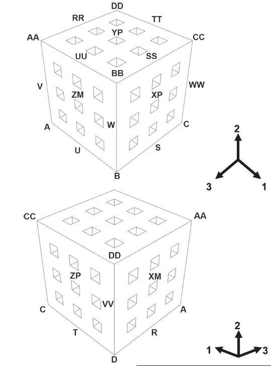

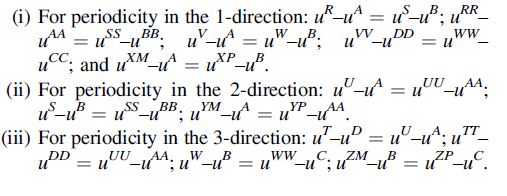

I have attached the sketch of the model that I have been working on. The notations A, AA, B, BB, C, CC, D, DD are vertex points. Notations ZM, ZP, XP, XM are surfaces of the model. the notations U, V, W, S, WW, T, R, SS, UU, RR, TT, VV are the edges of the model. The other image provided explains the type of BCs that has to be applied to the model.
