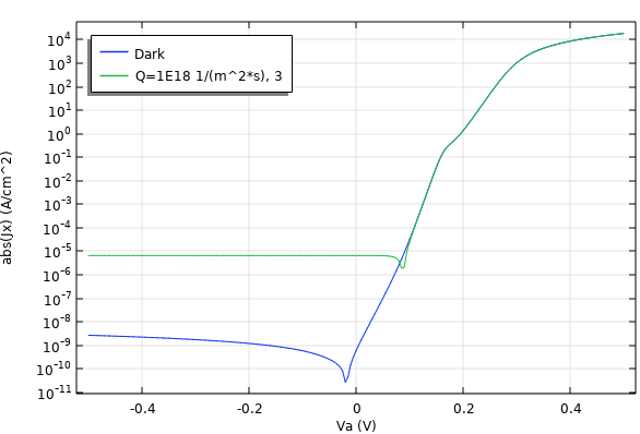

I constructed a photodetector in the Semiconductor module, and then performed a parametric sweep with two parameters, the incident photon flux and bias voltage. For the incident photon flux, only two values were swept, 0 and a non zero value. The aim is to get I-V curves with and without light illumination. Then I got the two I-V curves at two incident photon flux as shown in the appended figure.
Now, I'd like to calculate the difference between the two curves to get net photon current. I tried a lot but didn't manage. The question is how to calculate Jx (current density) minus itself at two incident photon flux parameter values within the results of a parametric sweep.

Thanks a lot, Edgar! I've tried both. The problems are (1) the variable I'd like to process is within the same data set (solution), seems I can't use these operators to distinguish. (2) I also tried to use two different studies, each defines a different incident photon flux, then sweep voltage. I tried with() and withsol() operators, it seems can't handle a swept variable. I got constant, not a curve.
I am not very familiar with these operators, so probably I didn't use them right. Regards, Ares
>Ares, > >Check the with() and withsol() operators in the documentation. > >Cheers >Edgar Thanks a lot, Edgar! I've tried both. The problems are (1) the variable I'd like to process is within the same data set (solution), seems I can't use these operators to distinguish. (2) I also tried to use two different studies, each defines a different incident photon flux, then sweep voltage. I tried with() and withsol() operators, it seems can't handle a swept variable. I got constant, not a curve. I am not very familiar with these operators, so probably I didn't use them right. Regards, Ares

Hi Edgar, I've got the withsol() operator work. The problem now is, it seems it can only evaluate one data point each time. For example, I have swept two parameters, Q and Va, then I used the following expression: withsol('sol7', abs(semi.JX), setind(Q,1), setval(Va, -0.5)) Then I get one JX value at Q=1 and Va=-0.5. If I don't assign the Va value, it returns the last Va.
I'd like to set one Q value, and then get JX versus all Va values. By using the "setind" and "setval" inside the "withsol()", I can only get one data point designated by (Q,1) and (Va, -0.5). I failed to find a way to define a range for Va. Can this be solved?
Many thanks for your patience and time! Ares
