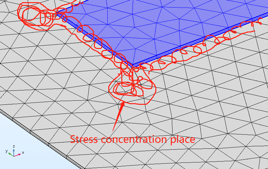

I have read the link you introduced. While I still have some problems. If the data evaluated by the operator "gpeval(4,expre)" is interpolated at Gauss Points near the input coordinate, what's the meaning of gpeval(4,expre,-1), gpeval(4,expre,0), gpeval(4,expre,1) respectively? I am facing the problem of stress concentration when plotting the energy flow (solid.IX, solid.IY) in a 3D vector field (The reason why use Arrow Volume to plot plane vector field is that the coordinate of evaluation points can be controlled in Arrow Volume). I found gpeval(4,expre,-1) and gpeval(4,expre,1 and above) can have almost same vector field that is chaotic near the stress concentration place (-1, 1 and above exorder all can be convergent but chaotic). Only gpeval(4,expre,0) can give a smooth result (I don't understand why the expre 0 that is between -1 and 1 can have a smooth result), but still different from the result of Arrow Surface Uniform Placement (Select evaluation points by COMSOL itself).
I found when I plot the vector field with Arrow Surface and only set the uniform total arrows number to let COMSOL select evaluate points placement automatically, the result vector field is smooth, reasonable and satisfactory. So I gauss maybe COMSOL internally conduct some smooth and average algorithm (Maybe average the data at many Gauss Points near stress concentration place? )? Or another possible situation is that COMSOL just simply evaluate solid.IX (or solid.SX) at Gauss Points near input coordinate and interpolate, then the reason why the "COMSOL Arrow Surface automatically selected points" can be smooth is that COMSOL avoids the stress concentration place when it select arrow placement automatically? Which one is COMSOL's internal automatical evaluating method?
And if I just simply plot solid.IX at mesh nodes, the resulting pattern can be reasonable (But the arrows is not dense enough if I don't add unnecessary denser mesh). Consequently, I gauss the chaotic vectors at stress concentration place may be caused by the COMSOL interpolation. How can I solve this problem? The stress concentration place is near the 90 [deg] joint angle of two layers of stairs.
Do you have any suggestion to solve the problem of stress concentration? Or just avoid inputting the coordinate near stress concentration place and avoid evaluating mesh nodes data near stress concentration place when I analyze the energy flux?
Thank you very much! Look forward to your reply.

Dear Mr. Henrik,
Thank you very much for your explanation! Your reply helps me have a deeper understanding of the COMSOL physical variable evaluation.

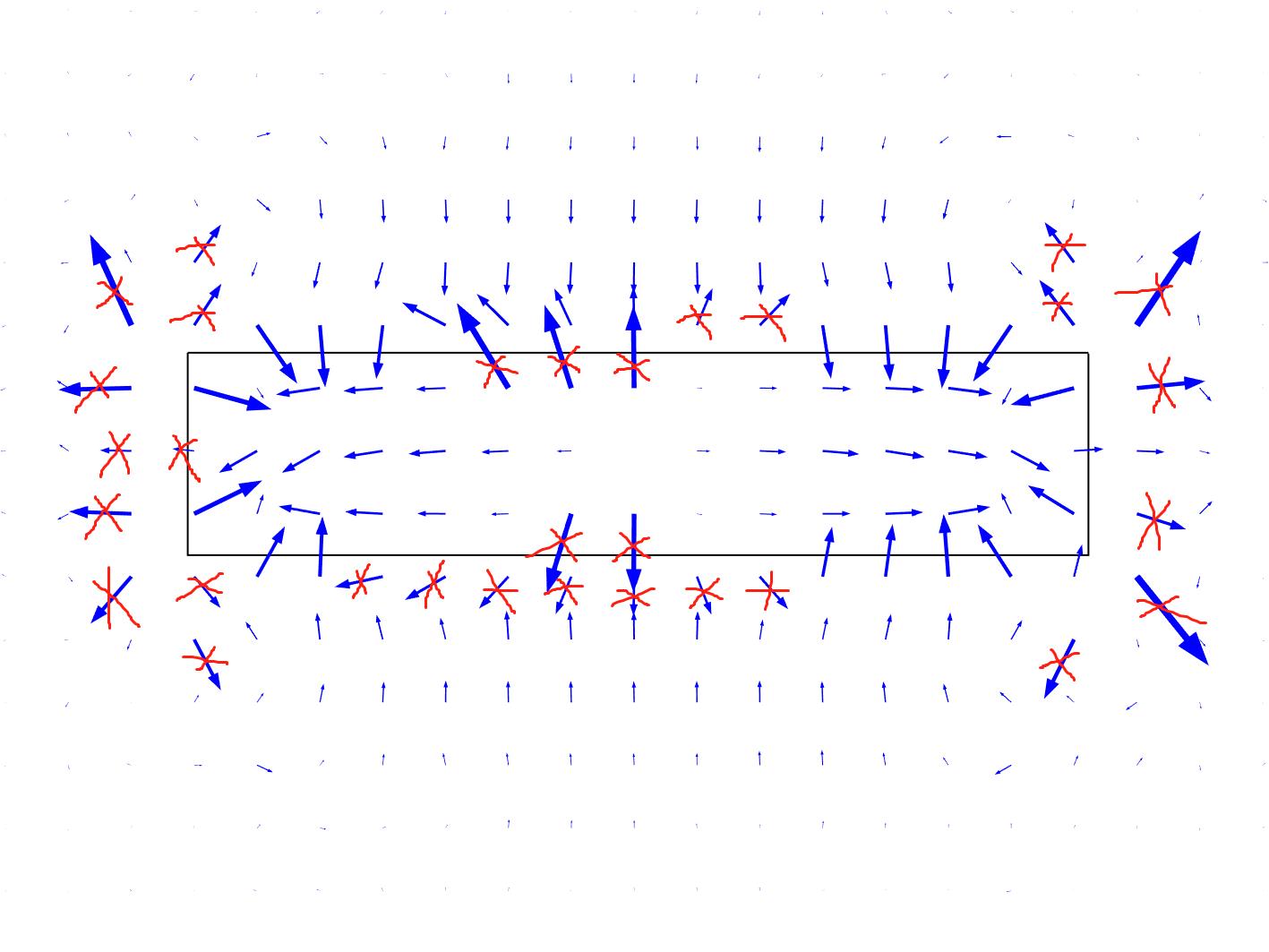

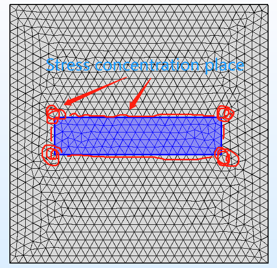

My problem is caused by the interpolation error on the stress concentration region, so gpeval(4,expre,0) should be more suitable for me (Just evaluate the data on Gauss Points and do not interplate). I tried to use "mphinterp" operator to extract calculated data and conduct more optimization work in MATLAB, while the extracted interpolated data is also chaotic because of the interpolation error on the stress concentration region. Therefore, it seems that the only choice for me is to evaluate the original data at mesh nodes and delete the data on the stress concentration region.
In my model, the stress concentration region is the joint part of two steps, as shown in the first two figures in the attachment. The third figure shows the chaotic energy flux vector field in the stress concentration region, and the vectors marked with red "x" are incorrect ones (Amplitude and direction are all incorrect). The model is consist of two layers of panels that are stuck together and under excitation. So stress concentration phenomenon will happen near the margin of the smaller block on the bigger block. Do you have any suggestions to solve this kind of stress concentration problem?
