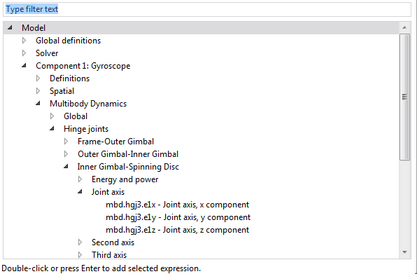

Magnus suggestion is the way to go for 'reverse engineering', but what if you were to set up that variable 'theta' without knowing that you were looking for mbd.hgj3.e1z?
In this scenario you know that you are looking for the orientation of the axis of Inner Gimbal-Spinning Disc, but not what its variable is called.
Then you have two options:
  1. Go to Equation View under Inner Gimbal-Spinning Disc and try to find it. You can sort the Description column in alphabetical order.
  2. Use the Replace Expression dialog, and try to find it in a more structured manner (see screenshot). This, however assumes that the variable you are looking for is announced as a postprocessing variable. Most variables that you as a user would be interested in can probably be found this way. In order to have access to the Replace Expression dialog, you must have some results. Run a Get Initial Value if there is no solution yet.

Magnus suggestion is the way to go for 'reverse engineering', but what if you were to set up that variable 'theta' without knowing that you were looking for mbd.hgj3.e1z? In this scenario you know that you are looking for the orientation of the axis of **Inner Gimbal-Spinning Disc**, but not what its variable is called. Then you have two options: 1. Go to **Equation View** under **Inner Gimbal-Spinning Disc** and try to find it. You can sort the Description column in alphabetical order. 2. Use the **Replace Expression** dialog, and try to find it in a more structured manner (see screenshot). This, however assumes that the variable you are looking for is announced as a postprocessing variable. Most variables that you as a user would be interested in can probably be found this way. In order to have access to the **Replace Expression** dialog, you must have some results. Run a **Get Initial Value** if there is no solution yet. Regards, Henrik
