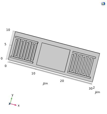

Iam herewith attaching the image of my device for reference as there is a problem with the file upload. pls suggest some way to upload the file I will upload the file and I can have some suggestions from you.

I can't tell what the problem is with file upload. The image is no help in figuring out what your problem is.
In general I advise setting up and solving a simpler, smaller 2D problem before attempting a 3D solution.
