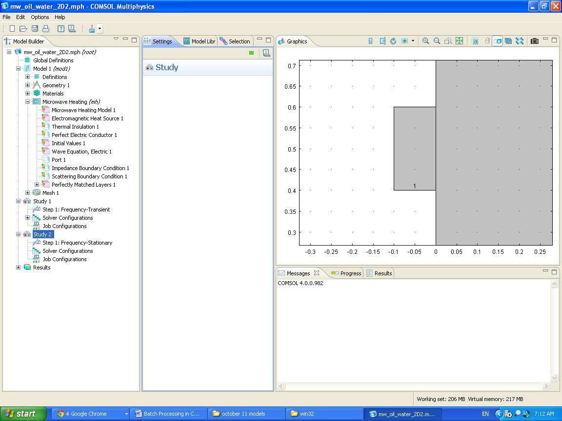

                                                    Hi everybody,
I've got an additional question for my microwave oven problem:
I'm about to learn the microwave oven basics, yet, but I was wondering about the port-Boundary-condition in the RF-Modul. I can't find any information about these port stuff when I take a look at the microwave basics.
I know, that the port is the wave-excitation-part in this simulation. Is it the size of the excitating magnetron?
Where can I get to know, what's the size of such a thing in real life? Could I get these informations from CEM?
Thanks for any help
greetz
Timo

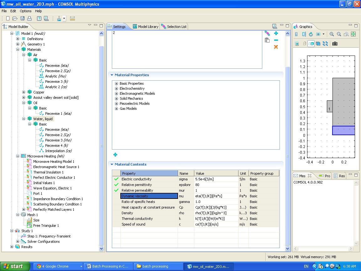

                                                    Hi Sohan,
The dielectric for water i.e. 78-11*j, is it incorporating the fact of change in dielectric constant with the increase in temperature?
In addition do you know about the dielectric constant for crude oil?
I am trying to heat oil with the microwaves heating (RF module) using version 4.0 of COMSOL, but the temperature distribution which I am getting is very huge as compared to the real word and it is also confined to the area adjoining the microwaves port. In real word scenario, temperature should reach a few hundered degree celsius in heating for a day almost and also temperature distribution should be present at a distance say 50% wayay from the source inside the material. Although it will be small but it will be there. In my case I am getting temperature distribution of a few thousand degree Celsius near the port and confined in almost 10 cm distance from the source, which is strange for me.
Can you suggest any potential reason behind this?
Many thanks in advance for any feedback!

                                                    Thanks a lot Mr.Nagi (JazakAllah khair)!
Do you mean to say that I have to define thermal conductivity and specific heat capacity as a function temperature as for the time being I am just defining them as constants e.g. thermal conductivity=0.04299(W/m*K) and Heat Capacity at Constant Pressure as 2130(J/Kg*K).
I am also interested in getting the dynamic behavior of oil with the change in temperature, can you please suggest something how can I obtain it?
Many thanks in advance!

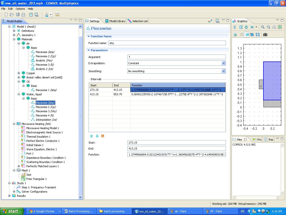

                                                    Thanks a lot brother for answering!
I am trying to find out some relationship of viscosity with temperature and thermal conductivity plus dielectric constant with temperature. But some one suggested me to define the material properties in the way being defined by the built in materials, please find attached the images (water1.jpeg for the properties shown for water defined as built in function, highlighted is the dynamic viscosity, second image is function of temperature.jpeg and shows how dynamic viscosity has been defined as a function of temperature). I am not sure how to incorporate such functions in my model for oil, can you please suggest some thing?
Secondly as you mentioned that at high temperatures, viscosity drops much and the natural convection should also be incorporated. If I find some temperature -viscosity relationship for oil and include it in the model for oil properties, will it not cover this phenomenon of natural convection? Should I have to include it as another parameter or function?
Many thanks for your feedback!

                                Oct 26, 2011, 10:31 a.m. EDT
                                                    Instead of providing linear regression equation in piece-wise function, you can use interpolation as it was done for speed of sound properties of water.
For taking into account of the convention, you need to use solve Navier-Stokes equations. I would recommend you to first set the RF physics right as convection will not change your microwave power distributions in the domain. alter on you can add up more physics.

                            Thanks a lot Sohan for answering!
Would it work fine if I define all of the properties of oil as interpolation without even one of them as piece wise as I see in the built in functions they use mixture of interpolation and piece wise?
Secondly, would you please elaborate your saying about convection?
What do you mean by saying "Set your Physics Right and After on you can change your Physics"?
Many Thanks in advance for your response!

                                                    Thanks Sohan,
After getting the heat dissipation with electromagnetic model, how can I change the properties of material?
As far as I think, the file will be the same and material properties will also remain same. I can change the study but how can I change the properties of material for second study?
In addition, how can I use this heat dissipation (obtained in case of electromagnetic heating) as initial stage for the heat conduction and convection model of second study?
This is the main problem: how to change the properties of material for second study while keeping the results of first study as initial conditions for second study?
I will really appreciate your response.
Many Thanks for your time.
                            Thanks Sohan,
                                Nagi Elabbasi
                                                                                                                                                    Facebook Reality Labs
                                                Posted:
                                1 decade ago
                                Oct 27, 2011, 4:35 p.m. EDT
                                                    You can change the material properties between studies. What COMSOL will take from the EM study is the heat generation. If your thermal conductivity changes in the second study, there is no problem.
If the dielectric properties of the oil however vary with temperature then you cannot solve for the EM field just once. You can leave out that level of complexity until you have worked out the other issues. Build up the model complexity gradually as Sohan described.
Also, including viscosity by itself in a fluid flow model does not account for natural convection. You need to couple the fluid flow model to the heat transfer one, and account for convection using the Boussinesq approximation or something similar (there are some relevant examples in the COMSOL model gallery).

                                                    Thanks a lot brother for your answer!
I tried to setup an other study but I have the properties of the materials as the same as you can see in the attached image. I want to run the first study with some settings of the material and then use the result of first study as base point for the second study.
If I proceed with simulation of first study and then change the settings of material properties manually and carryout the second study, is it the same what I want? I mean is COMSOL using the results of my first study as starting point or initial conditions for the second study, if not then how can I do that?
For the dielectric constant change with temperature, if I define my dielectric constant as interpolation function by inserting a table (different dielectric strength for different temperature) in the input of dielectric properties of oil, and simulate isn't it being considered as dynamic dielectric constant by COMSOL? Will the results of my simulation will incorporate the change in dielectric strength?
Thanks a lot once again for your time and support, JazakAllah!

                                                Posted:
                                1 decade ago
                                Oct 31, 2011, 10:31 a.m. EDT
                                                    There is no need to simulate frequency-stationary study. Instead of it, I recommend you to add RF module and perform study with frequency domain solver. This will take material properties at initial temperature. Once you get satisfactory result showing power density, solve the coupled MW heat transfer using transient solver.
Sohan

                                                    Rehman,
It looks like you are stuck with the COMSOL approach which they use for developing MW oven library model. One has to understand why did they took only half model and created those complicated input equations. Only reason of created that model is to reduce the size so that user can run at least that model on laptops.
When you use complete 3-d model or 2-d model you do not necessarily need to provide E-field value and cutoff frequency. You simply select rectangular port type and plug in input microwave power.
I am puzzled why do not get answer when you sandwich water in between oil layer.
To troubleshoot the problem, first assign same properties (oil or water) to all layers and run the model. If it runs for both material properties then it is not the issue with material properties.
How did you create those layers?. Make sure you have activated union instead of assembly in geometry creation.
If problem still persists, send me your model file, I can quickly look in it.
With best wishes,
Sohan
                            Rehman,
With best wishes,

                                                    Assalam o alaykum brother,
I am also trying to convert water into steam at a specific temperature (say 100 degree Celsius). I could not find any latent heat of vaporization in COMSOL and was wondering how can I define it.I have just a block of water and I am heating it with microwaves. It should absorb the heat and water should be converted to steam.
I also tried to change the specific heat capacity of water as suggested by you to Timo last time but on checking its specific heat capacity I found it defined as piece wise format:
Start 273.15 , End: 553.75 and  Function: 12010.1471-80.4072879*T^1+0.309866854*T^2-5.38186884E-4*T^3+3.62536437E-7*T^4
How can I change this expression for it to include specific heat capacity very high near the boiling point of water?
Can you please suggest some thing?
Thanks.
Thanks.

                                                    There are several ways to do that. One way is to add to Cp a built-in “Rectangle” COMSOL function that acts around 100 Celsius (say from 98 to 102). The function value should be zero below 98 and above 102, and equal to the latent heat divided by 4 between 98 and 102.  Make sure as Ivar mentioned to select a smooth function and make sure also that the time stepping is small enough to not skip over that narrow temperature range.
Nagi Elabbasi
Veryst Engineering

                                                    Thanks brother!
I have tried to define the rectangle function but I was only able to define it in "Global Definitions" or "Definitions" section. I could not find a way to apply this function to Cp. In addition it was automatically taking the highest value as 1 inside the duration. How can I change this value from 1 to "Cp/4" inside the interval?
Can you please suggest some thing by having a look on the attached file?
Thanks.
                            Thanks brother!
Thanks.
                                Ivar KJELBERG
                                                Posted:
                                1 decade ago
                                Dec 28, 2011, 3:35 a.m. EST
Hi there are two ways, once the function has been defined:
Either in the physics node ou define a UserDefined Cp with the expression referring to the different functions or parameters or typing you need, ...
 or directly in the related material node in the Cp variable field

                                                    Thanks Ivar,
Still I am not getting it how to include the function value inside my Cp calculation? As you would have seen in the file I sent you last time, the built in Cp is being defined as a function of T as
with temperature ranging from 273 to 575 Kelvin.
Do you mean that I should define Cp as this function ranging from 273 to 371 Kelvin and 375 to 575 Kelvin while rectangular function will be defined as Cp/4 in between 371 and 375 Kelvin?
If so, it can also be defined as an interpolation function without caring for definition of rectangular function, am I right?
Please clarify...
Thanks.
                            Thanks Ivar,
Please clarify...
Thanks.
                                Ivar KJELBERG
                                                Posted:
                                1 decade ago
                                Dec 28, 2011, 12:16 p.m. EST
if you want to refer to a function, only reated to a material property, you can create/add a new material, then right click the "Basic" node and add local fuctions therein, and refer to them in your material property expressions. Check how it's don ein the "complex" materials inthe built-in material library, (i.e. "air"),
with the interpolation function you can use higher order interpolation polynomial to make it rather "smooth", following the values as Nagi explained
