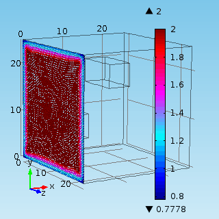

Posted: 1 decade ago Feb 1, 2012, 3:01 a.m. EST
Your model seems to work for me as well. I've attached an animated GIF of the particle flow that I see.
Posted: 1 decade ago Feb 1, 2012, 12:33 p.m. EST
Thanks for the help.
Looking more closely at the details of the particle trajectory module vs. the particle tracing module, I've realized where I was mistaken.
I didn't see that the particle trajectory module was modeling only the x component of the particles velocities. I was expecting it to show the movement of the particles based on the velocity streamlines as is done with the particle tracing visualization.
Within the particle tracing, however, I cannot get the particles to be release from the whole inlet face. I've tried modifying the expression for the particle positioning but cannot get the YZ face to release particles. Do you have any suggestions? This issue, with the release, is partly why I was trying to use the new module in the first place.
Attached is the updated file.
As a side note, my model also will not solve for the poincare map.
Thanks for the help. Looking more closely at the details of the particle trajectory module vs. the particle tracing module, I've realized where I was mistaken. I didn't see that the particle trajectory module was modeling only the x component of the particles velocities. I was expecting it to show the movement of the particles based on the velocity streamlines as is done with the particle tracing visualization. Within the particle tracing, however, I cannot get the particles to be release from the whole inlet face. I've tried modifying the expression for the particle positioning but cannot get the YZ face to release particles. Do you have any suggestions? This issue, with the release, is partly why I was trying to use the new module in the first place. Attached is the updated file. As a side note, my model also will not solve for the poincare map.
