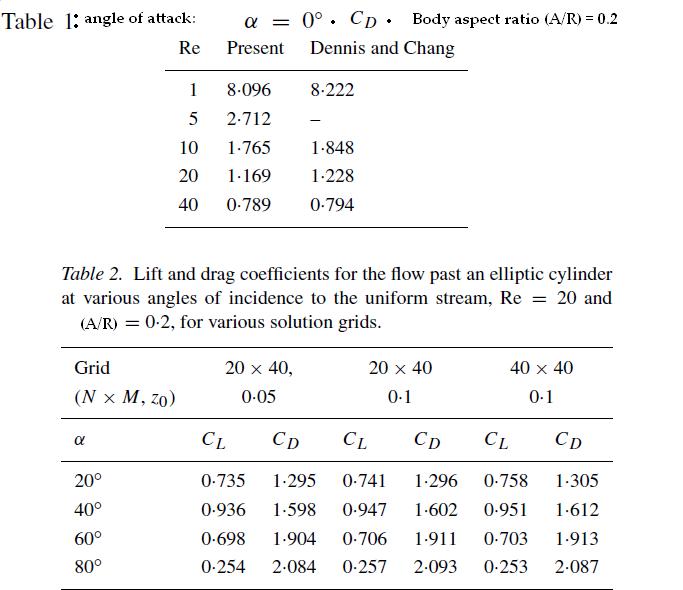

For comparison I used
S.C.R. DENNIS1 and P.J.S. YOUNG2
Steady flow past an elliptic cylinder inclined to the stream
Journal of Engineering Mathematics 47: 101–120, 2003.
Please some one tell me what mistake I am doing.

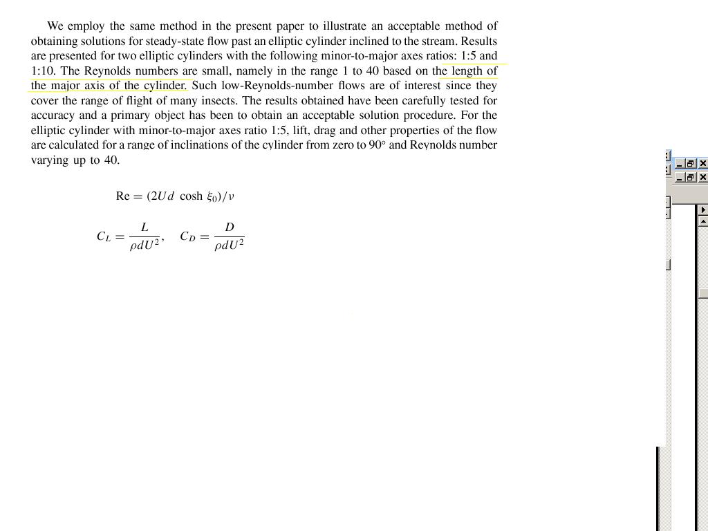

Thanks a lot Dr. Ivar.
I have used Young's definition of Reynolds number using non-dimensional characteristic lengths. He calculated Reynolds number based on the major axis of ellipse and non-dimensionalised by Re = (2 Ud cosh ξ /ν) where tanξ = b/a. I calculated this through that 'f' in that paramater table. Moreover I calculated drag coefficient using Cd or Cl = lineintegral of the boundary : reacf(u or v)/(rho1.L*U^2). Please see the picture attached from that reference.

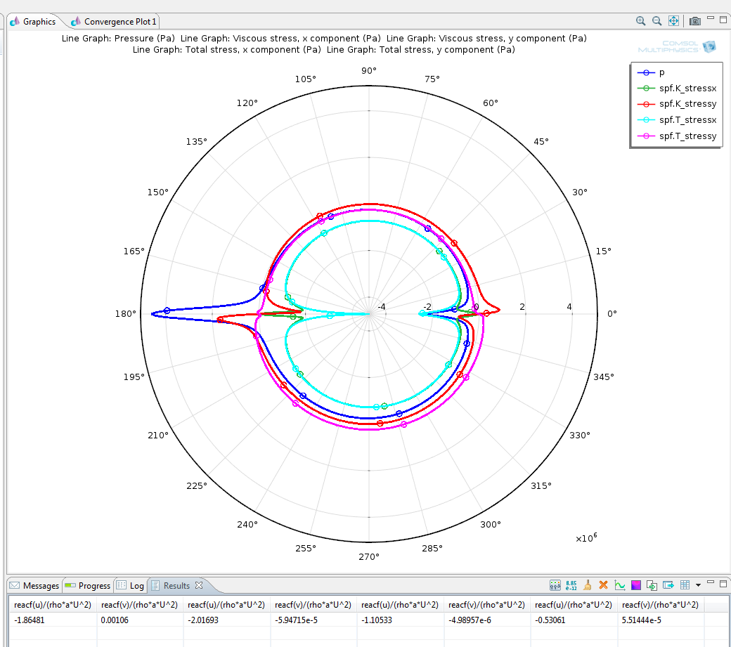

What I often like is to use a polar plot to see the sear components:
add a polar plot node, add a line graph node to the polar plot, Theta angle Parameter use expression and type atan2(y,x) (instead of spf.U), select you "ellps" for the 4 boundaries, and select the pressure p. then to improve the reading, in Color and Style, select width "2" and line marker "Cycle", add a legend, select manual and type "p (Pa)" (it's not automatic).
Then duplicate 4 times the line node and replace the variable and the legend respectively by: spf.K_stressx , spf.K_stressy , spf.T_stressx, spf.T_stressy.
Note the reacf(u) will not be easy to interpret, as its only defined on the nodes
Ideally one should make the same plot but for a shape slightly "inside the fluid", that can be obtained by adding an internal fluid boundary at 10% about greater size than the solid ellipse
Finally I would hesitate to use the extremely fine mesh for this case ;)

Regarding Re of elliptical cylinders:
The charect. length is taken differently by different authors, some take minor axis, some major axis and some equate the area of ellipse to circle and find the equivavalent dia to take as charect. length. But however, if we take Re defined as in the paper, should't we get matching results?- irrespective of the way how we measure Re.
I think still there seem to be big difference in results....
for your perusal I have attached the paper.

indeed the article is nice and interesting. As usual these theoreticians, use dimensionless values all over, so going back to "dimensonal" ones can be tricky, and anyhow, even if they make a scaling error the demonstration remains valid, it's us the engineers and practicians that have problems to get these theories to fit with our surrounding world.
You have a few choices, you can run COMSOL dimensionelss too, but I find it far to easy to do stupid scaling errors that are difficult to identify, up to you ;)
But, you should start to check that you are using the COMSOL CFD equations as equation (1) as stated in the abstract: they solve "Navier Stoces for incompressible fluids", as the CFD of COMSOL has different sub categories (see the main physics node, and track the changes in the equations and dependent variables.
Then check the dependent variables (you need (u,v)[m/s] and p[Pa]) and you have the parameter "R" that depends on constants U [m/s], d[m] and eta [m^2/s]. I agree here they define the dimension "d" as the major axis, so let^s use that to dimension U.

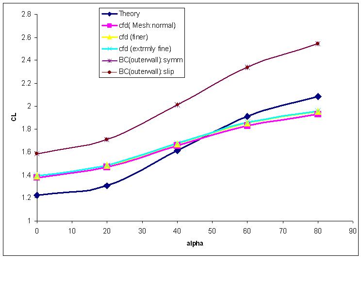

Thanks again Dr. Ivar for a detailed and point to point explanation.
I am reading and applying your thoughts.
I have managed some of them (like mesh: normal, fine and finer, BC: slip, open and symmetry). I have compared them with the theory and attached in the picture.
It makes some sense now and I am able to understand the situation.
though there is difference, is it negligible?, is't the comsol algorithm is superior to the one in the paper?

Posted: 1 decade ago Jan 11, 2012, 6:20 a.m. EST
well what is the ratio between BC out symmetry with extremely fine mesh and the theory ?
something like 1.6/1.2 = 1.33
But that not far off from your selected "rho" w.r.t "1" or 1000 kg/m^3 which is a usual normalisation value often used for "rho".
Could that be an issue, missing a normalisation w.r.t. physical dimensional "rho" somewhere ?

Posted: 1 decade ago Jan 11, 2012, 8:29 a.m. EST
Hi. thanks again.
Yes. BC outer: symmetry and slip wall gives almost same shape of curve as in theory only they are 0.4 units away uniformly. should I have to add this anywhere to get in agreement with theory? wont it change the outputs again...
Just out of curiosity, made the fluid domain bigger and bigger till i get the matching value...and got too for a very big rectangle around ellipse. Is this approach physically meaningful or just a trick ;-)

Posted: 1 decade ago Jan 11, 2012, 8:55 a.m. EST
not necessarily. But if your mesh remains fine enough (doubling mesh size gives just a few % changes) then you should be mesh independent, then the effect you observe could indeed indicate that you do not have "infinite" enough distance between the "wall" and the wing.
You could try with an "open boundary" instead of "symmetric" one , the former will free the flow in and out, the latter force a parallel flow.
Or perhaps integrate the pressure and drag on the symmetric wall, if its not influencing the wing it should have values independent of the wing orientation
And as you are using glycerine you should check the dynamic viscosity [m^2/s] and the overall transverse (heigh) dimensions of your system.
