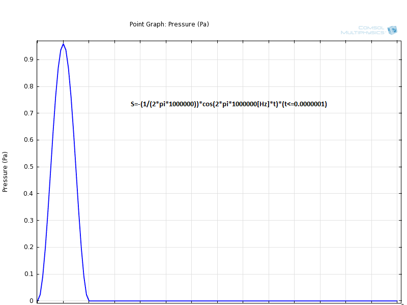

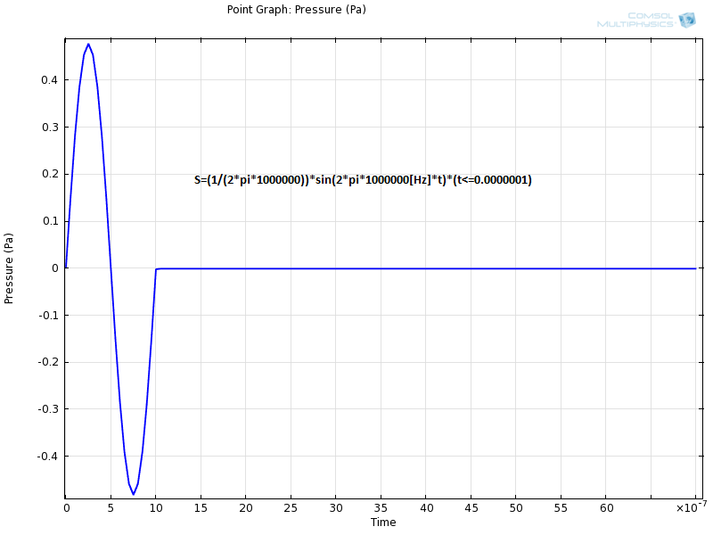

I found it rather strange while i was setting the flow point source .
The equation that it uses is the dS/dt to define the source.
When i define S=(1/(2*pi*1000000))*sin(2*pi*1000000[Hz]*t)*(t<=0.0000001) i should be getting
a cosine pulse when 0<t<0.000001 and zero otherwise. But it gives me a sine pulse of magnitude
0.5 as shown in Fig 1.
The second strange result that i observed was when i used S=-(1/(2*pi*1000000))*cos(2*pi*1000000[Hz]*t)*(t<=0.0000001) i should be getting a sine pulse when 0<t<0.0000001 and zero otherwise. But it gives me a srange result as shown in Fig 2.
Looks simple but im quite stumped at these results.

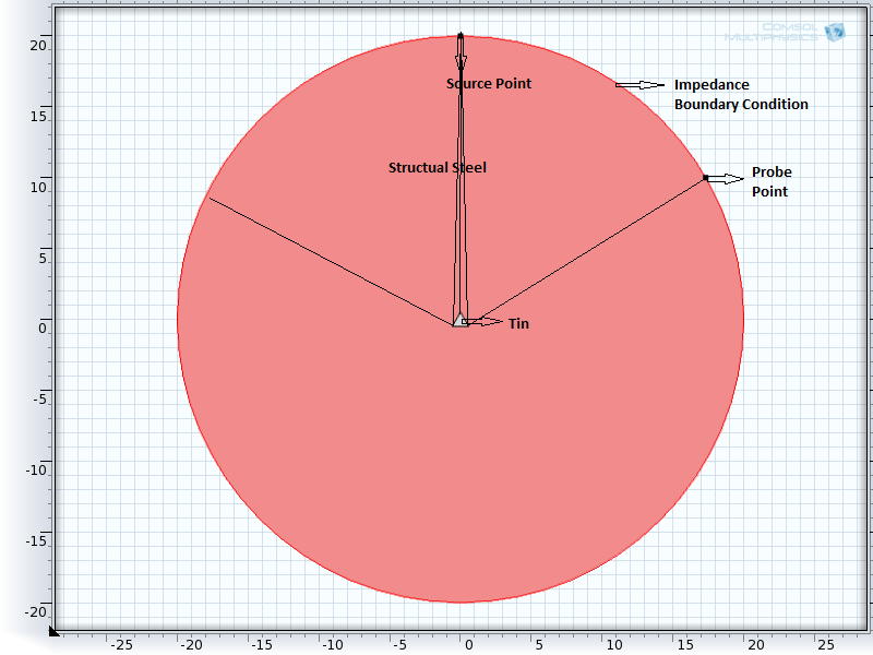

Let me put it in a better way with a figure of my geometry.
I'm not checking these functions in the analytic section. But giving them as inputs to the problem.
It asks us to enter the S field but in the equation it uses dS/dt.
I use point graph to obtain Fig1 & 2 using the source point as the point to plot the graph for.
Thanks a lot for your time and effort.
