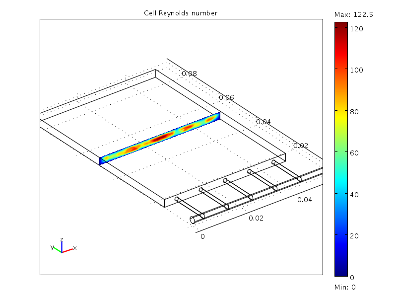

I am a student with very minimal experience with COMSOL (most of what I know, I have learned just from experimenting with the program). I am modeling fluid flow through a flow chamber (see attached model). COMSOL was able to find a solution when I ran the study for this model in an older version (either 3.5 or 3.5a, I can't remember). However, now that I have updated to 4.2a, running the same model fails to find a solution (Error message is "Maximum number of Newton iterations reached.") I have tried different mesh sizes, without success.
Since I am not familiar with the commands and capabilities of 4.2a, I am hoping someone can direct me toward where I am going wrong. I have attached images of some results I obtained from running the model in the older version (Reynolds number and velocity field slices). I need these results to be verified when I run the same model in 4.2a, before I can move on to redesigning the chamber.

Your problem interested me so much that I downloaded your model file. My first impression was that your mesh is rather sparse. I changed the user-defined mesh, "General physics" to "Fluid dynamics" with the "Coarse" size. Then there was 108305 elements, hence 10-fold of yours. Then I changed in Solver configuration => Solver 1 => Stationary solver => Iterative 1 => Multigrid 1 => Mesh coarsening factor: 1. Thanks to Jukka in Comsol Helsinki office for telling me this hint!
You inlet velocity, 0.25 m/s sounded so high that I changed that to 0.025 m/s. The solution was reached in 10 minutes, but when I tried with 0.25 m/s, the solution did not converge. Hence, the reason might be physical. There may some turbulence in the corners of the thin pipe line, but your original mesh was so sparse that it did not see it. Maybe I am wrong, but you should have at least 4 layers in z direction in the larger domain to make velocity profile meaningful. Due to the five pipelines into the large domain, a swept mesh cannot be done (at least I was not able to accomplish it).
