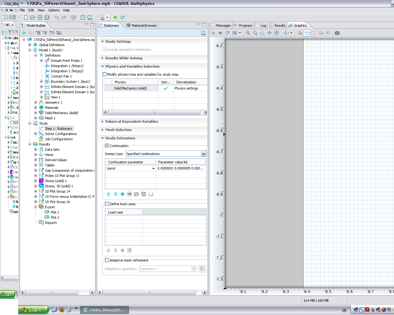

What are you using for your time dependent tip movement control? Parametric sweep or continuation. I would say that you would better use continuation.

You can give values to " t" in continuation of parametric sweep. Use continuation. Please see the attached file. The second point is check that size of your mesh elements on the PMMA is 1.5 times smaller than the mesh size of your sphere. Check 2 times as well.

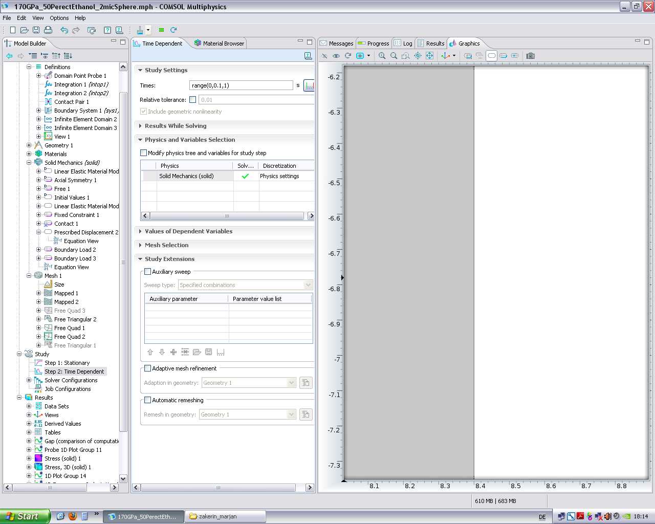

..... See the attached new file for the continuation time dependent solver
