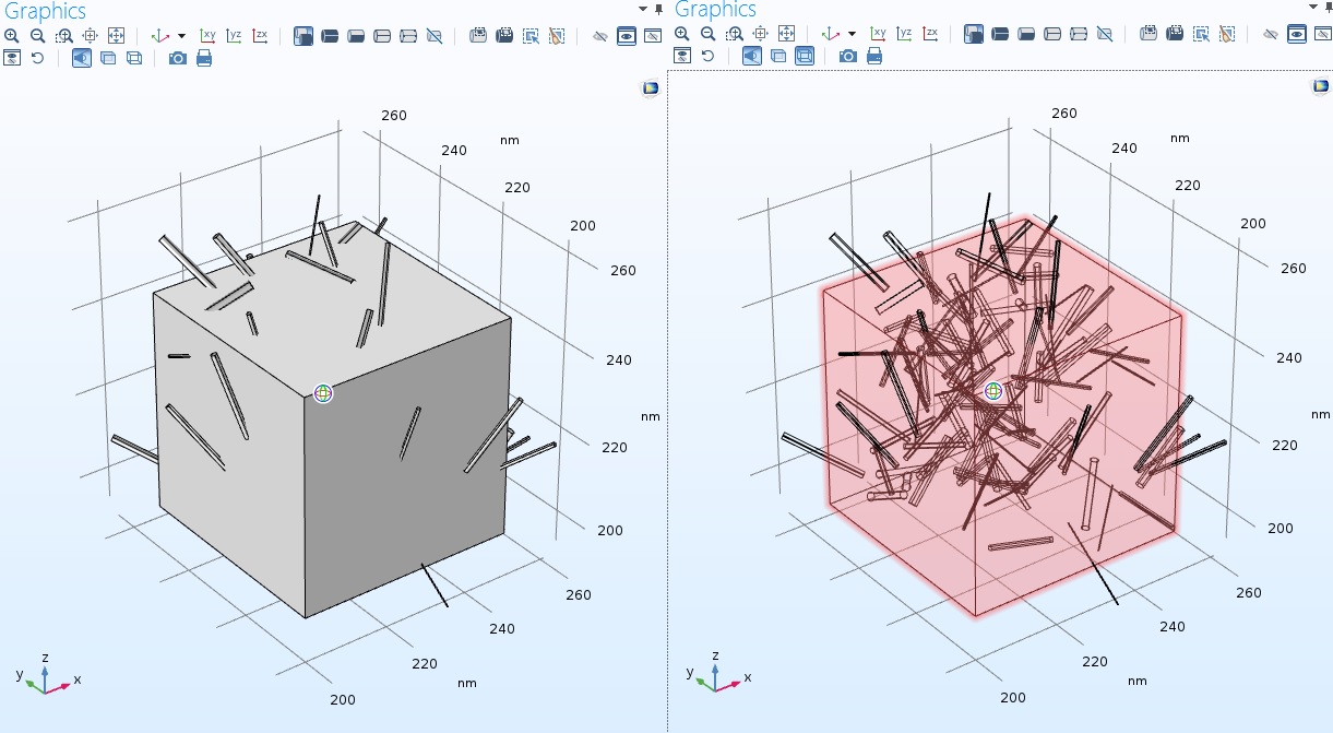

Thanks
I want to add fibres in a programming loop until a defined volume fraction is reached. Therefore, i dont think intop1() is what i need
Thanks
