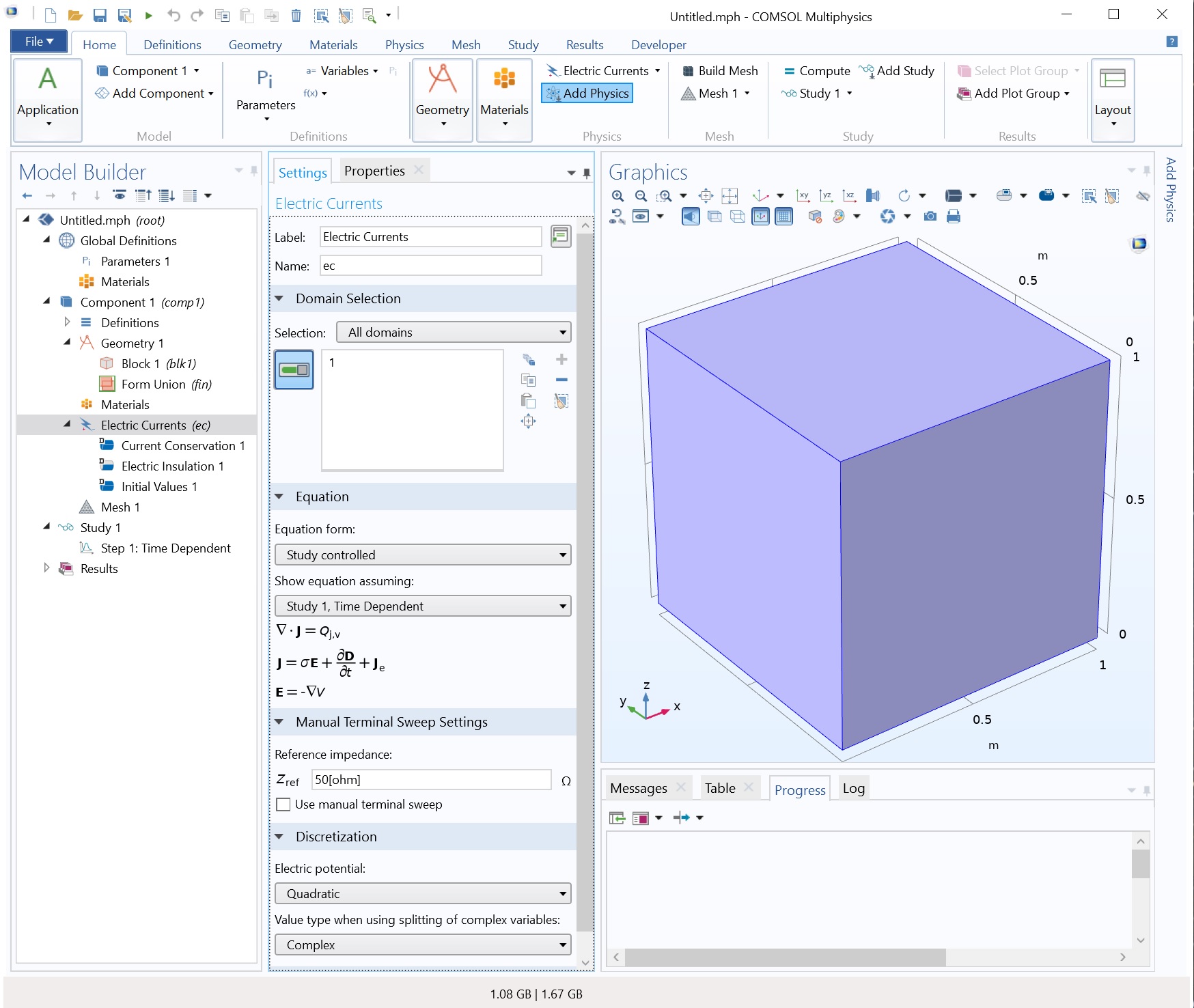

The EC formulation in the AC/DC module, with a time-dependent study, would be one of the options to consider. See screenshot attached.
