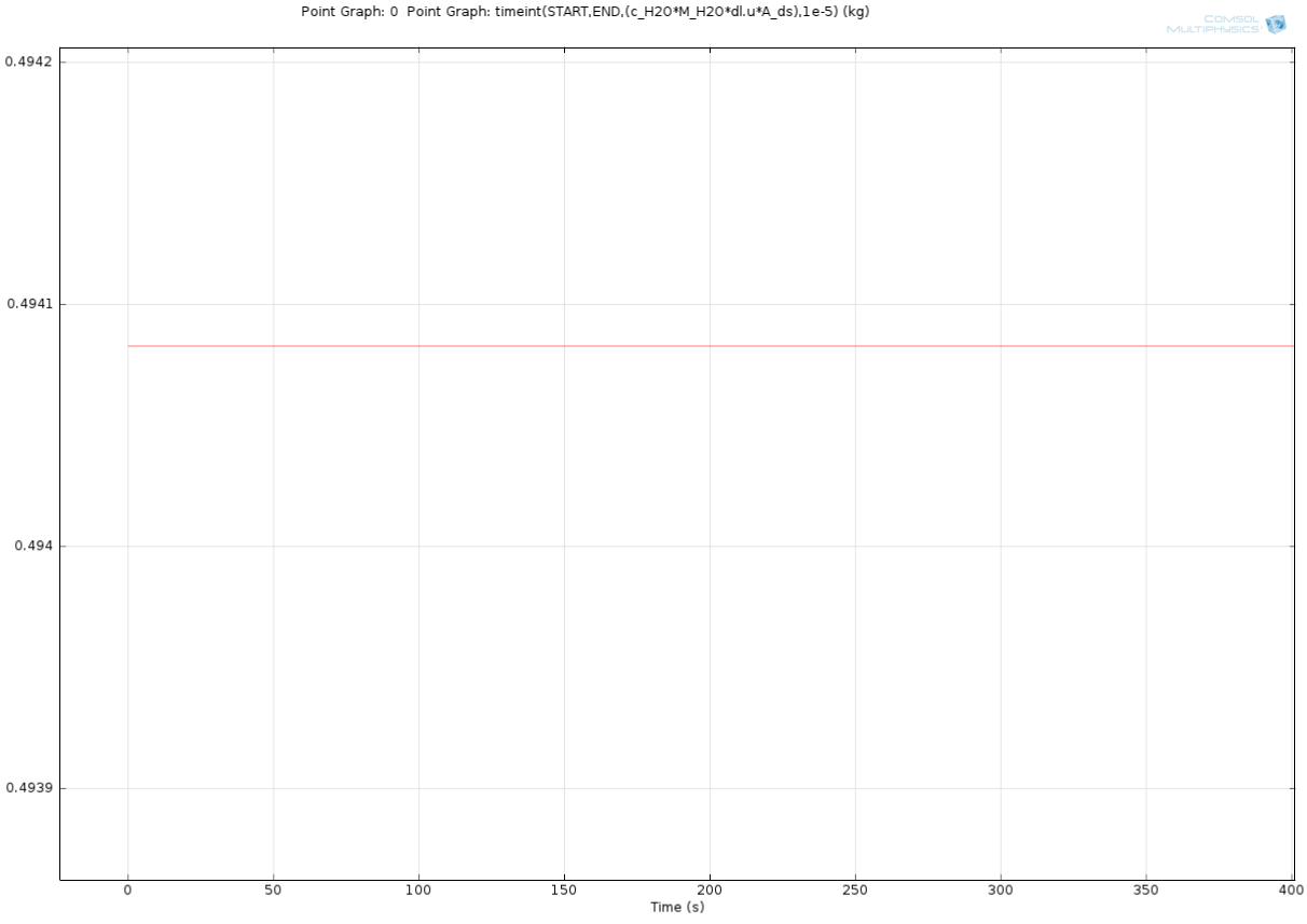

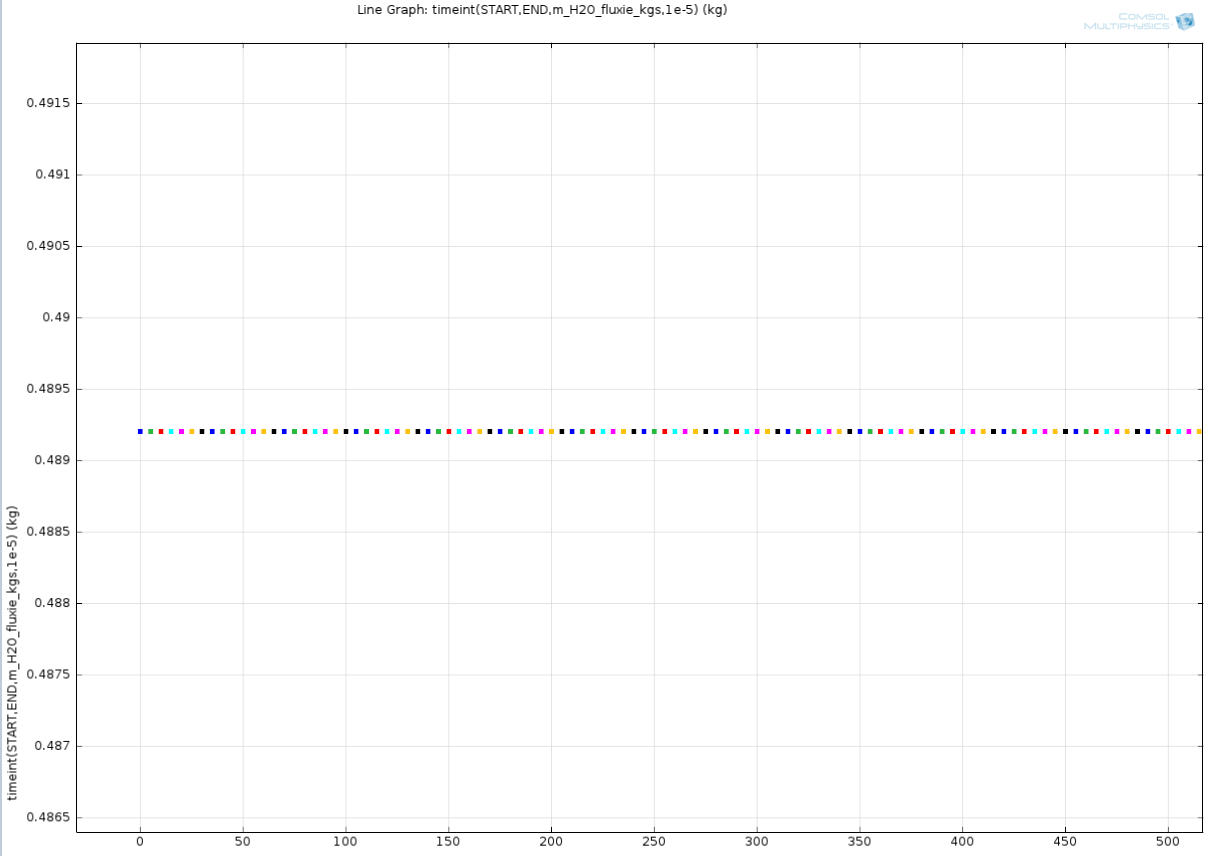

                                                    I said that with constant temperature I get 0.5% error but actually that is only when I exclude the Darcy's Law module, so only using Transport of species. If I include it again, I always get a 2% error (1.02 kg) for the time integration over the massflow at the exit boundary.
I have tried literally everything I can think of. Is this just the highest accuracy achievable? Is it because COMSOL uses FEM (finite element method) instead of FVM (finite volume method)? Am I doing something wrong?
Any thoughts here?
Any thoughts here?

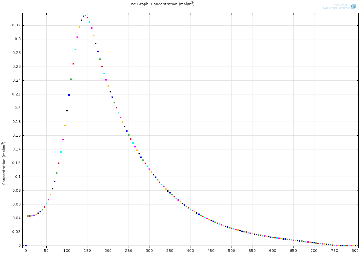

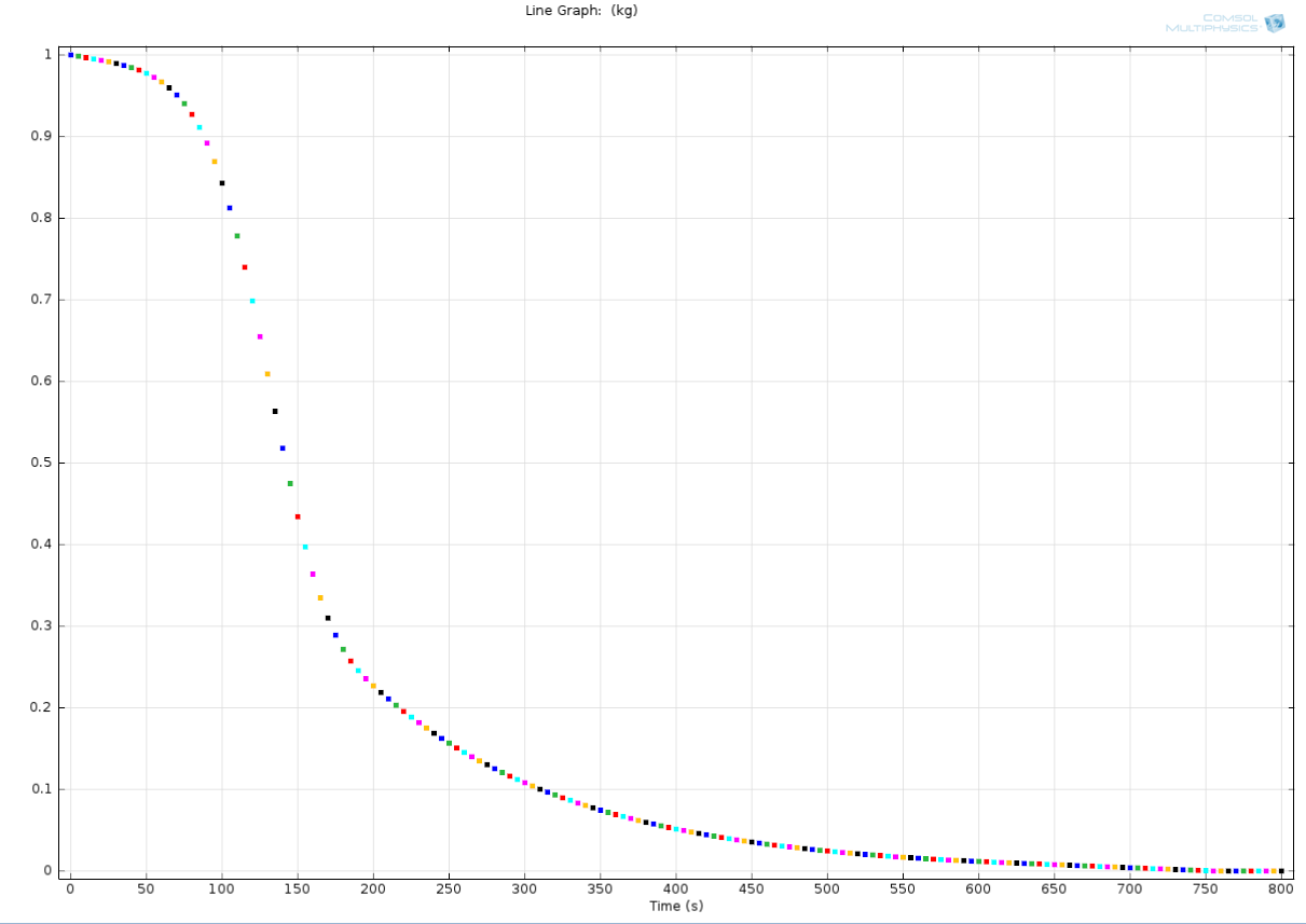

                                                    I need both modules because I need to know the concentrations, the mass/density and the velocity. I can calculate the concentrations with the Species Transport module and from that I could calculate the density myself using Ideal Gas Law (rho_i=P_i*M_i/RT=n_i*M_i/V=C_i*M_i) but the velocity changes as well and for that I need Darcy. The problem is that Species Transport does not include mass, only species, so I mirrored the species in Darcy to make COMSOL give the species 'real' mass for mass balance purposes. For constant temperature this looks quite ok, as I said, but when temperature changes, the balance is way off.
Has anyone done mass balances on time dependent studies? (using timeint?) Or other, general ideas?
Thanks for any input.
