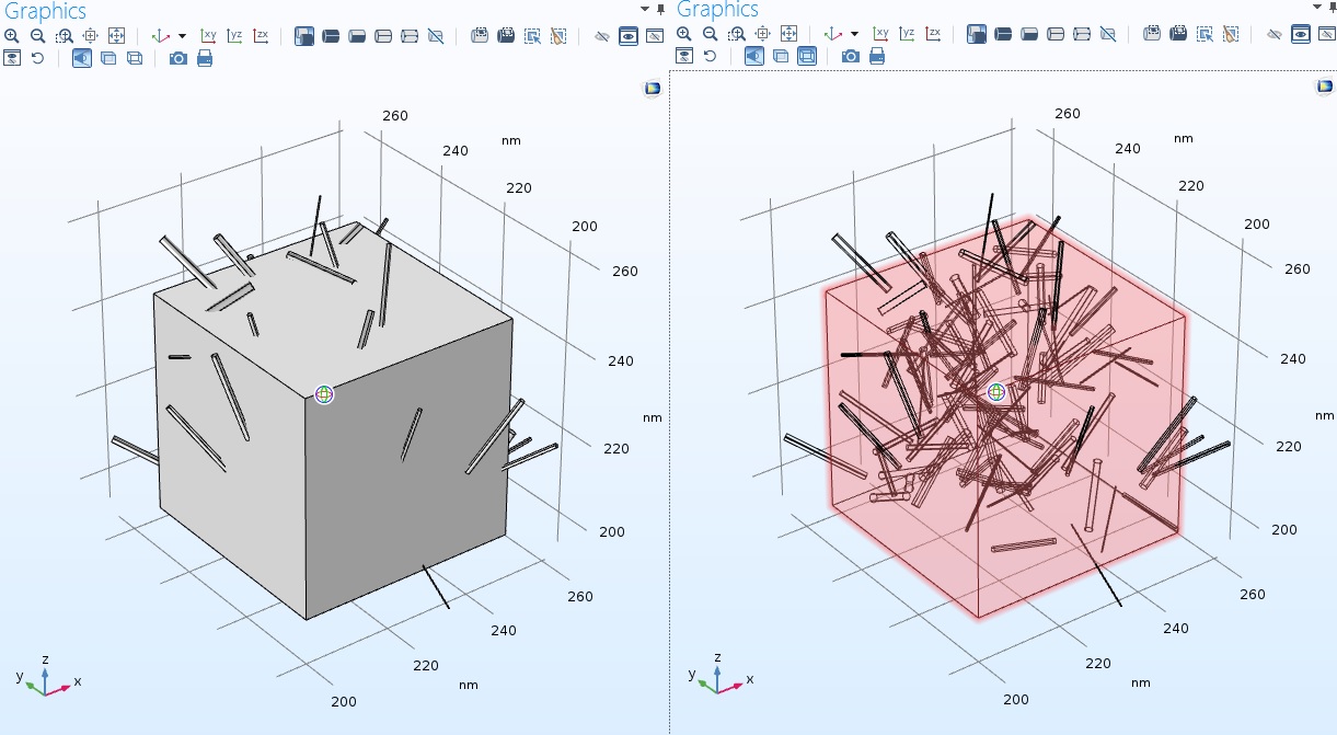

Hi everyone, I want to delete the segments of the cylinder geometries which lie outisde of the domain of the cube, and keep the segments which lie within the cube using the application builder coding. (see attached image). I have tried using the 'BoxSelection' tool: g.create("boxsel1","BoxSelection"); but i am unable to delete geometry outside of the domain selected. How can i do this using the inbuilt java code?

Not sure about the java code, but if you were using the user-interface, you would consider using simple Boolean operators (like intersection, for example), to keep only the domains inside the box. Does that help?
