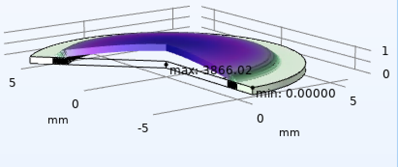

I have a model of a silicon wafer with a labyrinth to thermally isolate the center from a section of the outside. I am wanting to know how strong the wafer will be. I initially set up a 3d model by importing a CAD file, but the degrees of freedom were too massive so i have switched to a 2D model so I could do calculations faster. However, it seems any mass placed on the chip center whatsoever causes a huge displacement, which I think has something to do with the dimensional units but I can't find out where I have gone wrong. Furthermore, the chip center is displacing in the direction opposite of where is should be (up instead of down). I am a self-taught COMSOL user and will try to answer questions as best I can, and I understand this is a simple problem so thank you for your time.

I don't see what you say you see. I see plausible displacements due to gravity in the right direction.
Try using the gravity node or try exerting point forces.
Be sure to activate geometric nonlinearity.
I don't see what you say you see. I see plausible displacements due to gravity in the right direction. Try using the gravity node or try exerting point forces. Be sure to activate geometric nonlinearity.

That is strange, because when i plot the maximum and minimum displacement, is around 3 meters in the positive z direction, and I would expect the movement to be in the negative z direction. I have attached an image of my results.
Thank you again for your time, Marc
That is strange, because when i plot the maximum and minimum displacement, is around 3 meters in the positive z direction, and I would expect the movement to be in the negative z direction. I have attached an image of my results. Thank you again for your time, Marc

I don't have the software here to open your file, but I am going to guess that you're looking at modes, so that magnitude and orientation have no meaning.

Hi Marc, I don't have the software here to open your file, but I am going to guess that you're looking at modes, so that magnitude and orientation have no meaning. Best, Jeff

I only ran the static analysis, which makes perfect sense. The weird things are in the linear buckling analysis, which I have not had occasion to use.

When I run the static analysis (assuming that is the stationary step), the displacement I get is 0. Is this study step just using the intial values, and can I change that?

Using the gravity node does not have this issue, so I will just avoid using the added mass domain condition.
Thank you, Marc
Using the gravity node does not have this issue, so I will just avoid using the added mass domain condition. Thank you, Marc
