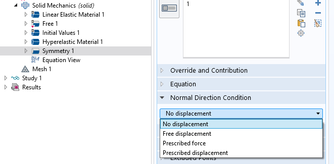

I think you are looking for one of the special variants of Normal Direction Condition in the Symmetry node, probably Free displacement.
See the attached screenshot.
Henrik Sönnerlind
COMSOL
I think you are looking for one of the special variants of **Normal Direction Condition** in the **Symmetry** node, probably **Free displacement**. See the attached screenshot.

Thanks so much, Henrik and Jeff! It looks like Henrik's solution does exactly what I want. I have no idea how I missed that option, after having spent all these hours playing around with the boundaries. (For simplicity, I haven't checked your solution, Jeff.)
