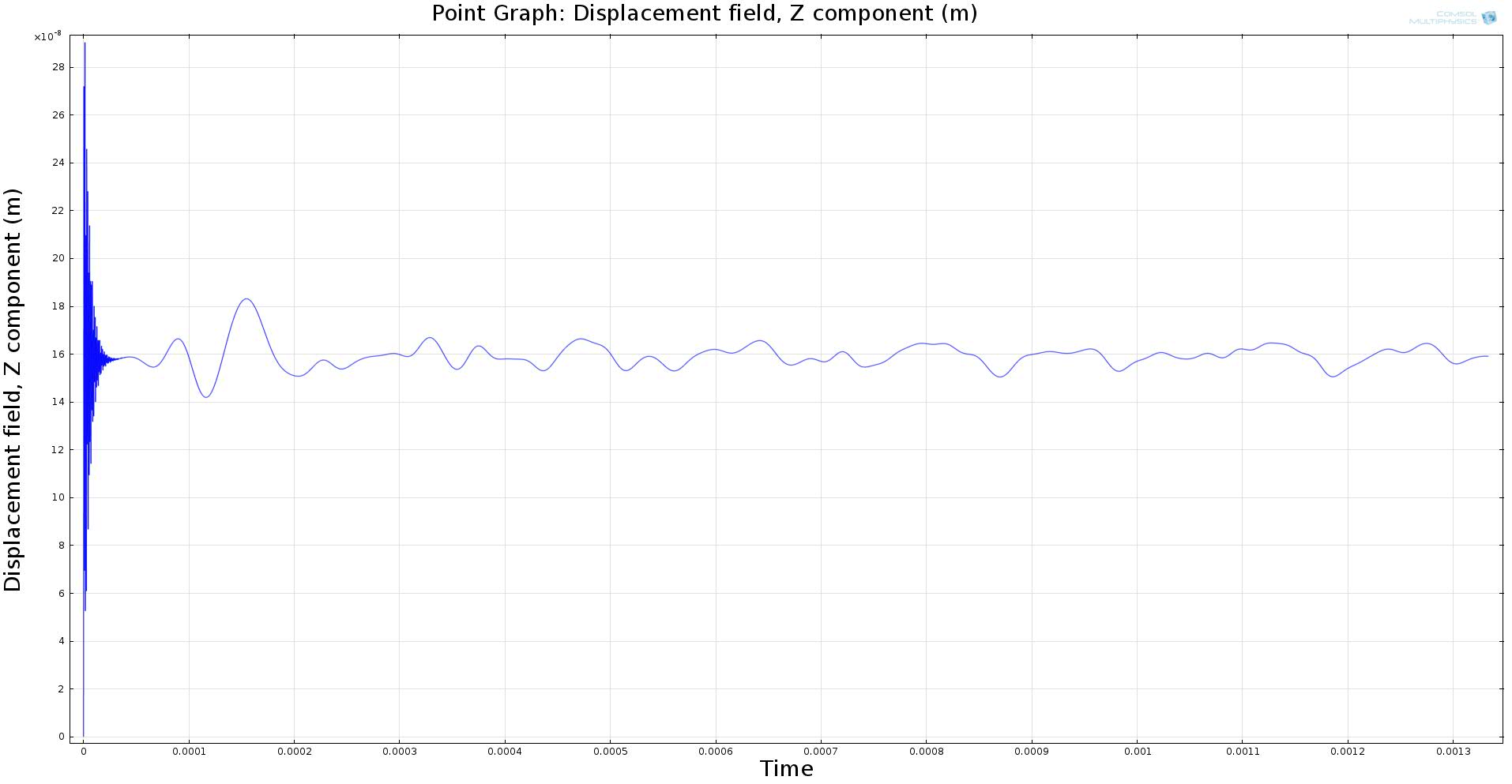

I am looking to pre-strain a membrane and am exploring the possibility of using thermal expansion to do it.
The model is a membrane 30[mm] diameter and 40[um] thickness. I use fixed constraint around the edge of the membrane.
I then add a Thermal Expansion node under Linear Elastic model 1, the values I use should give rise to 5% volumetric strain.
However, when I look at the Z displacement (normal to plane of membrane) there are vibrations. The first part of the vibrations looks like its numerical problems settling down, however there is a considerable vibration in the z direction, please see the attached.
Also, the vibrations looks to be offset by around 16e-8m, I would expect it to be at 0.
Does anyone know what might be going on here? As I do not have any material damping I think these vibrations would carry on. Also, the magnitude is about the magnitude of the displacements that I would be looking at at a alter point in the model.
Have I been stupid or is this a known problem of using Thermal Expansion as a way of inducing strain into a model.
Thanks for reading this, I hope people have some interesting ideas.

You can conceptually apply pre-strain via thermal expansion. Why not do a stationary solution instead of having to deal with these oscillations and damping?

or perhaps turn off the inertial terms (if possible for your model) that would drop the rho*d^2_u_/dt^2 term and work in Quasi static. Often a "Continuation sweep in stationary is easier as then you are working not only "quasi" but "fully static" to the solver resolution

I'mnot behind my COMSOL Ws just now, but previously (and I hope it's still true for v4.2a, I used to load a buckling example, that is (was) a combination of a statioanry analysis + eigenfrequency (set for buckling) and then looked at the way COMSOL linked then. I have also noted, that if you chain statioanry + transient, and hen do a create default solver sequence, COMOSL set the two up for a coupled analysis, with a stored solution in the middle and transient initial conditions set to the stored solution. What remains often confusing is that you get 2 data set, and the order are not always the one you expext, but by looking at the references one quickly finds out which is the stationary (solved solution) and which is the second transient case
