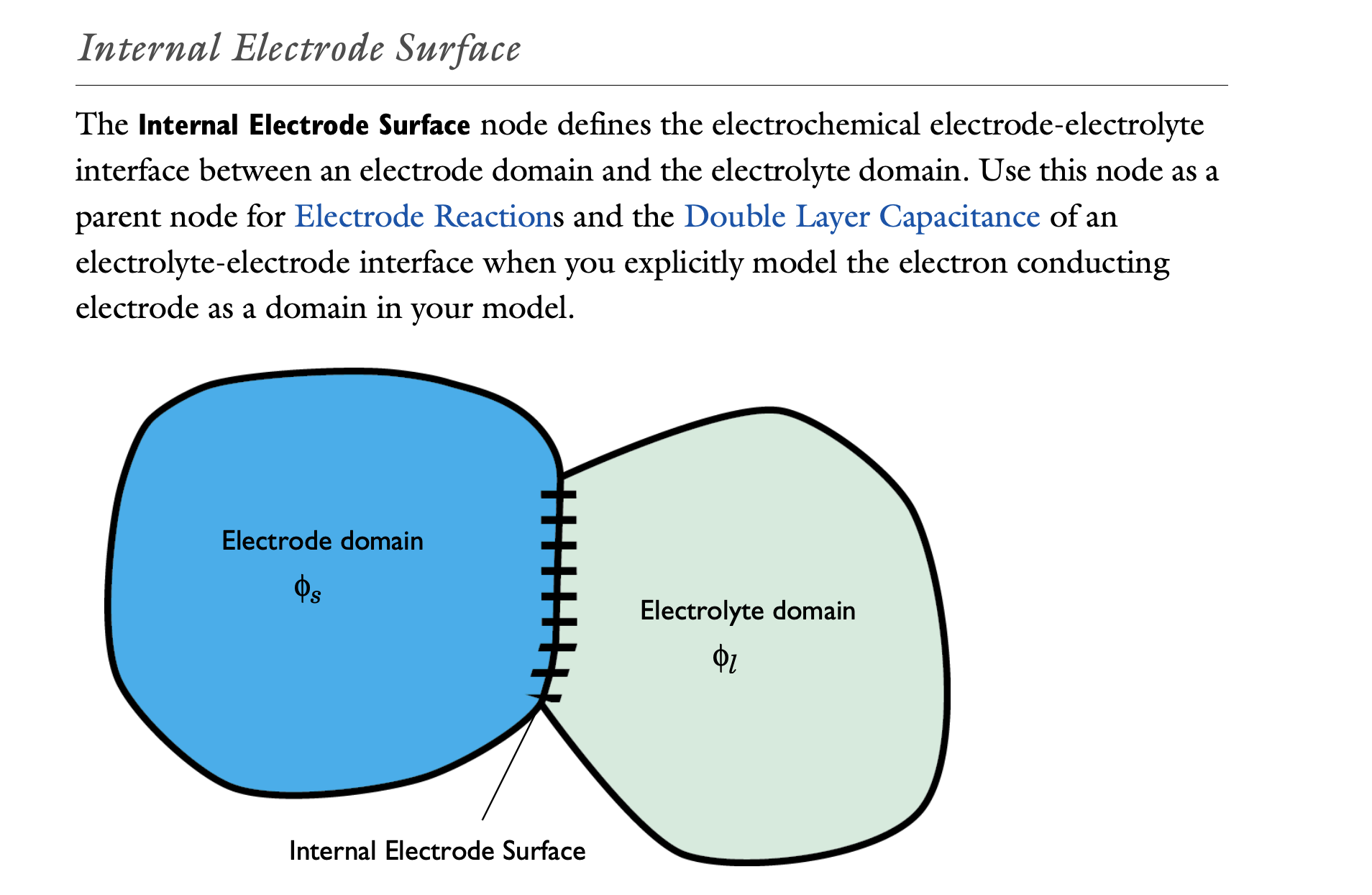

I am currently working on making the mesh of my geometry very dense. While working on this process, I read further in the Electrochemistry Module User's guide and it mentioned that the "Internal Electrode Surface" node should be used when the electrode itself is being explicitly modeled which in this case I am with the 3D thin film.
I primarily wanted to confirm if this would prove helpful in my case measuring the diffusive current to compare with the Cottrell Equation or if this node is more designed for specifically for electrode reactions or double layer capacitance being present. Any insight would be greatly appreciated, I am using an Academic Class Kit License Version 5.2a.
I have attached a screenshot below of the user's manual that I obtained my information from.

There is an earlier discussion about Cottrell current where I added a couple of comments. To which equation exactly you are trying to make the comparison?
Lasse
