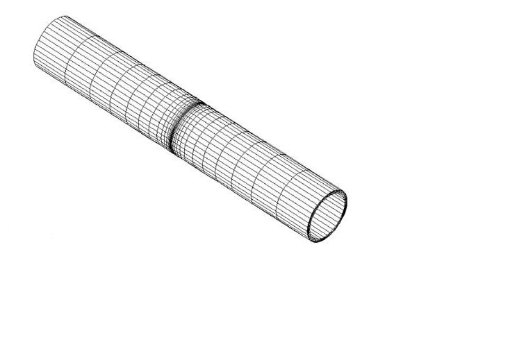

hi to all,
i am trying to solve laser forming on tube.. i want to pass the laser beam at center of the tube... i want to create denser mesh in middle of the tube(without any boundary in middle potion.).. here i have attached example diagram.. iwant to create the mesh technique...how can i create this mesh in comsol..i tried many times.. but i couldnot find out the mesh steps..
can you help me

There is "Refine" command under Mesh-More Operations where you can specify the size of the box with finer mesh.
