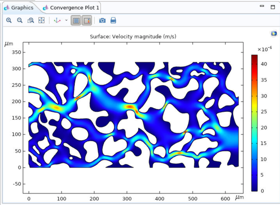

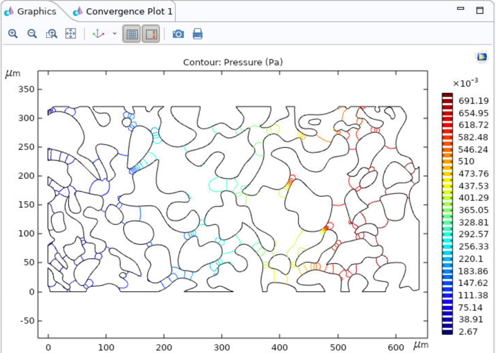

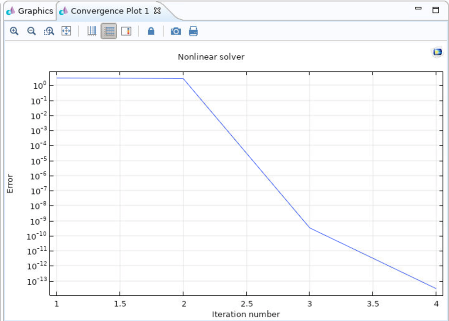

Hi everyone, I have recently replicated the Intro to Porous Media tutorial in COMSOL to build a baseline model that I can eventually add modules to and turn it into a model for chloride migration in concrete. The first time I ran the simulation, I did it exactly the way the demonstrator did it in the video tutorial (without NPP equations, only including the Creeping Flow module). The results were a surface velocity plot and contour pressure plot, with a convergence plot that did reach convergence. (screenshots attached of the 2 plots and the convergence plot that belongs to this simulation)

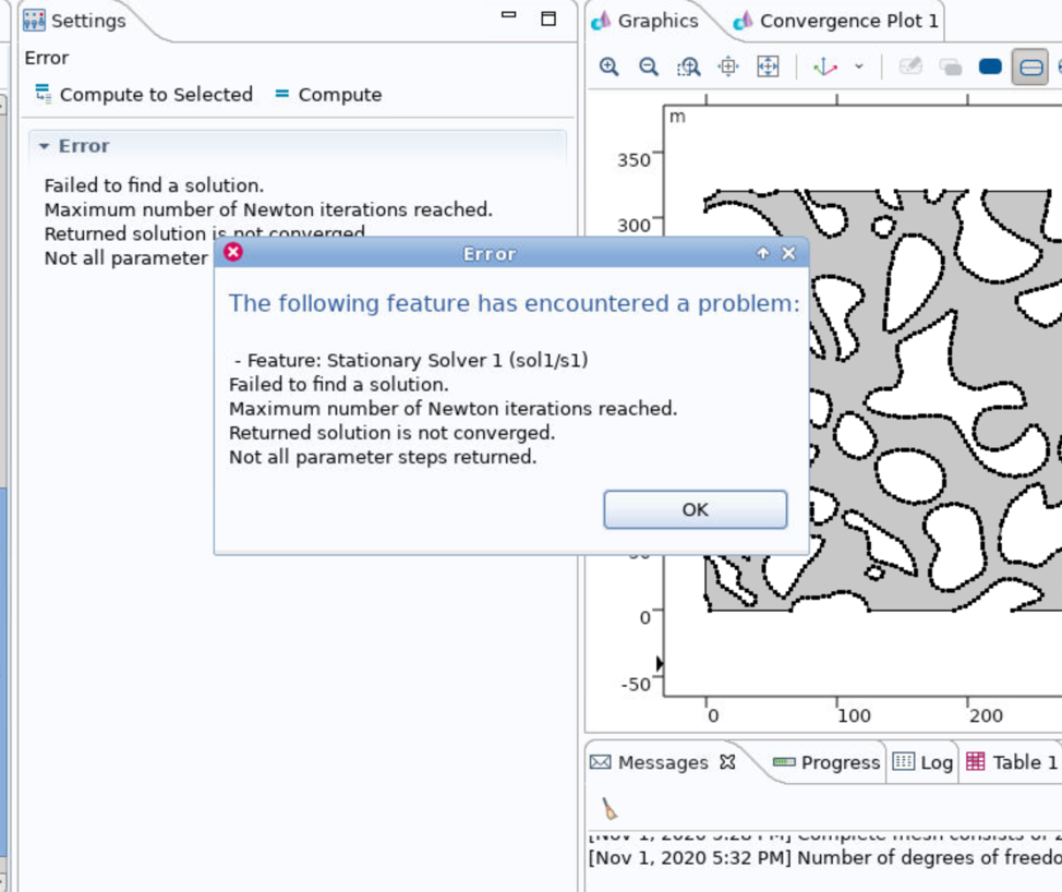

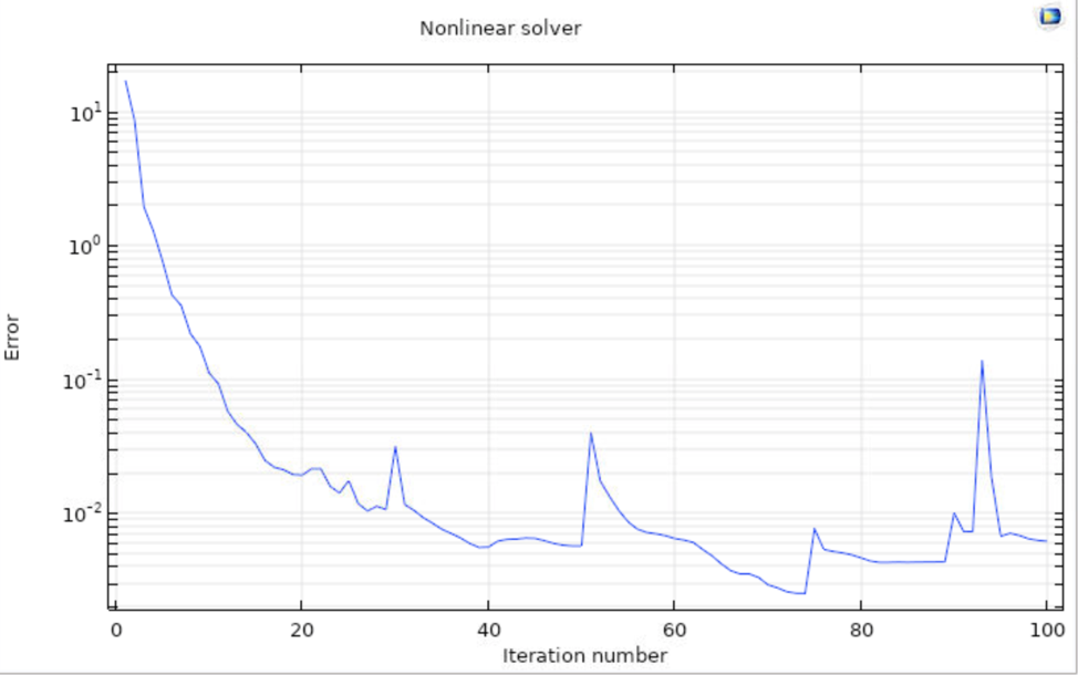

The second time I ran the simulation, I did the exact same simultion in the tutorial, but this time I also added the Nernst-Planck Poisson (NPP) equations from the Chemical Species Transport model because the NPP equations are required for the purposes of my project. This time, when I tried to perform the same studies from the original simulation tutorial, I got an error message and the 'convergence plot' did not reach convergence; the plot was more erratic with multiple peaks and did not converge. I should also mention that the study performed in both of the simulations I did were stationary, so time is not a factor here. (screenshots of the non-converging plot and error message are also attached)
