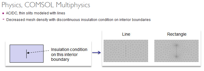

Does anyone have any idea how to do what is indicated in the attached? It is exactly what I need to do (form an electrically resistive slit) and it is mentioned like this in all the 4.0a release notes but I cannot find any details on how this is achieved.
For a start I cannot seem to simply draw a line even!?
Is anyone able to point me in the right direction with this one?
Thank you!

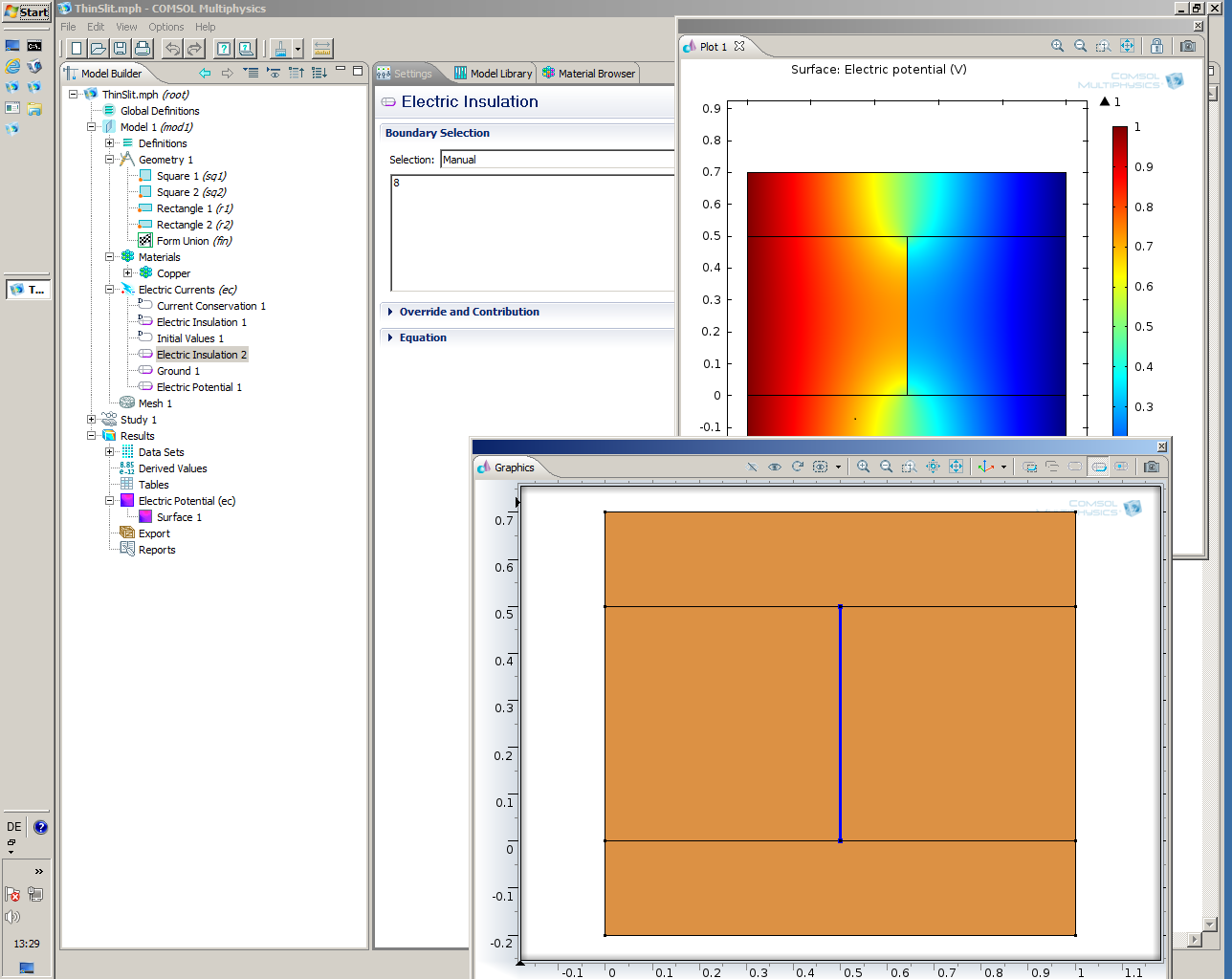

Posted: 1 decade ago Apr 3, 2012, 7:43 a.m. EDT
Here is the screenshot. I assembled those 4 domains, all are copper. This way I could set the internal boundary to insulation. Left and right boundary are set to 1V potential and ground. The other internal boundaries are continuous as default.
Cheers
Edgar
Here is the screenshot. I assembled those 4 domains, all are copper. This way I could set the internal boundary to insulation. Left and right boundary are set to 1V potential and ground. The other internal boundaries are continuous as default. Cheers Edgar
Posted: 1 decade ago Apr 3, 2012, 8:03 a.m. EDT
Okay great, thank you!
This will be a good starting point though eventually I'd like to model some random cracking and cavitation in my material so I don't think I'd be able to tessellate very large numbers of shapes in this manner.
I'm currently experimenting with using very large aspect ratio rectangles (100:1) and setting an electrical insulation boundary condition on them. It seems to be functioning though I had hoped that the suggested update in 4.0a would make this easier. I envisage that with the small size and large number of 'cracks' (rectangles) I will eventually run into meshing problems with my rectangle method.
Okay great, thank you! This will be a good starting point though eventually I'd like to model some random cracking and cavitation in my material so I don't think I'd be able to tessellate very large numbers of shapes in this manner. I'm currently experimenting with using very large aspect ratio rectangles (100:1) and setting an electrical insulation boundary condition on them. It seems to be functioning though I had hoped that the suggested update in 4.0a would make this easier. I envisage that with the small size and large number of 'cracks' (rectangles) I will eventually run into meshing problems with my rectangle method.
