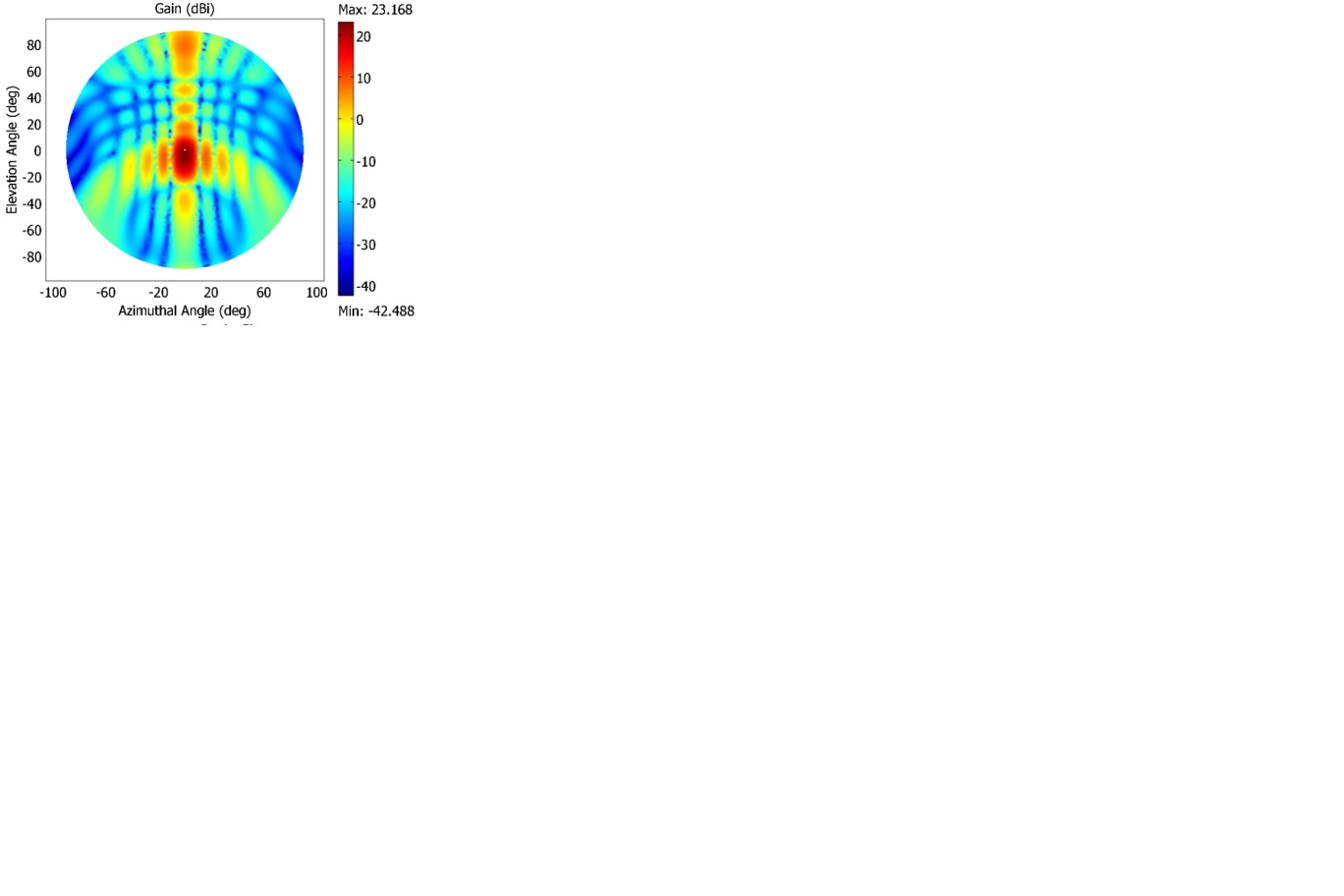

Hi Robert, thanks for the post. No, what I mean is projection of the hemisphere of the unit sphere onto a circle, so that we can easily see the beam pattern for the whole hemisphere without having to limit ourselves to a slice. The disadvantage is that the plot suffers from distortion on the edge of course. Please check this paper Section 4 gives some simple expressions to do this transformation.
I've found that the 'regular grid' in COMSOL takes the grid from the model space itself when exporting normdBEfar which is a bit confusing as the far field shouldn't depend on the model size or distance from the origin. I guess this must be an internal thing in how COMSOL works. I've extracted some data based on 'grid' with x,y,z swept from -1 to 1 and get the vector directions to the unit sphere and it seems OK, but still struggling with the coordinate transforms a bit.
Hi Robert, thanks for the post. No, what I mean is projection of the hemisphere of the unit sphere onto a circle, so that we can easily see the beam pattern for the whole hemisphere without having to limit ourselves to a slice. The disadvantage is that the plot suffers from distortion on the edge of course. [Please check this paper](https://www.nsi-mi.com/images/Technical_Papers/2007/AMTA07-0092-GFM_SFG.pdf) Section 4 gives some simple expressions to do this transformation. I've found that the 'regular grid' in COMSOL takes the grid from the model space itself when exporting normdBEfar which is a bit confusing as the far field shouldn't depend on the model size or distance from the origin. I guess this must be an internal thing in how COMSOL works. I've extracted some data based on 'grid' with x,y,z swept from -1 to 1 and get the vector directions to the unit sphere and it seems OK, but still struggling with the coordinate transforms a bit.

I guess one way would be to create a sphere in the model then plot normdBEfar on the surface of that sphere and position the camera to make the projection but its a bit hacky.

Ah. In the years prior to Comsol providing far-field pattern plots in post-processing (and before that, computing any far-field quantities at all), if you wanted to compute and plot something like that, you could place a sphere around the origin and create/write a set of your own equations, to compute and plot the quanties of interest on the surface of that sphere. I used to do that, long ago. I also remember looking at spheres along the axis, and making plots (on the screen) just like the projection you mentioned. I presume that same technique still works. I've attached an example image. Alternatively, if you want to actually make such plots on a disk (instead of looking at a sphere from a particular perspective) you ought to be able to do that via judicous use of coupling variables. I suggest you investigate along that path.
Ah. In the years prior to Comsol providing far-field pattern plots in post-processing (and before that, computing any far-field quantities at all), if you wanted to compute and plot something like that, you could place a sphere around the origin and create/write a set of your own equations, to compute and plot the quanties of interest on the surface of that sphere. I used to do that, long ago. I also remember looking at spheres along the axis, and making plots (on the screen) just like the projection you mentioned. I presume that same technique still works. I've attached an example image. Alternatively, if you want to actually make such plots on a disk (instead of looking at a sphere from a particular perspective) you ought to be able to do that via judicous use of *coupling variables*. I suggest you investigate along that path.
