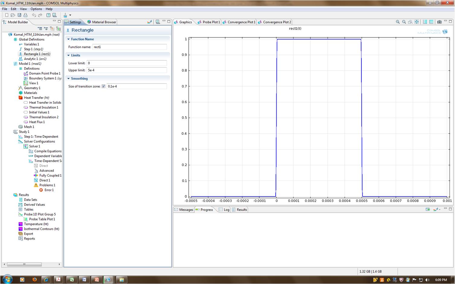

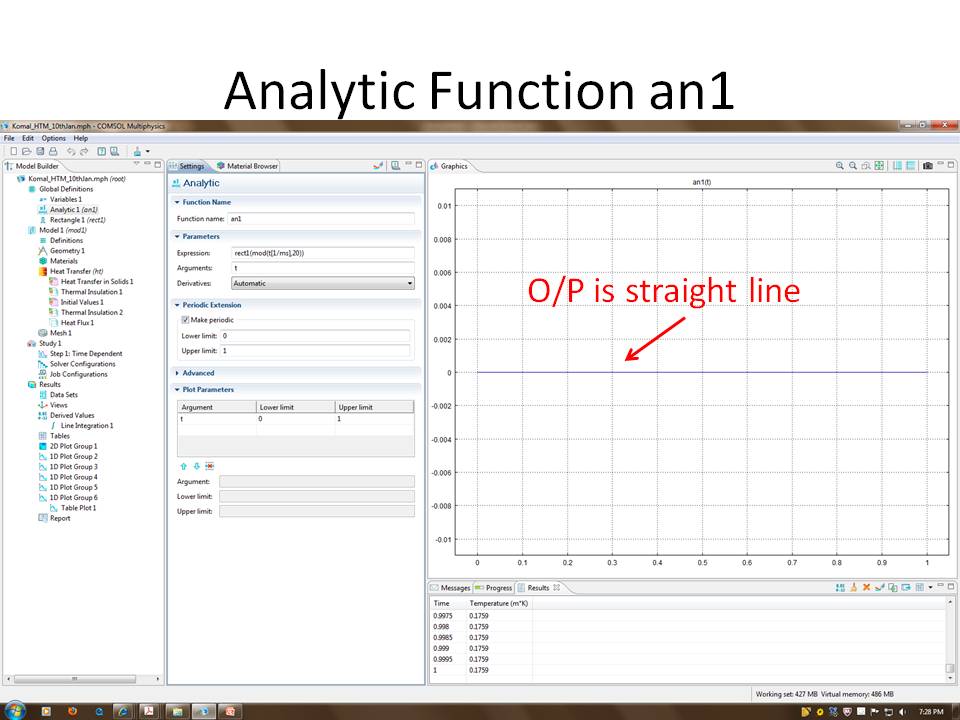

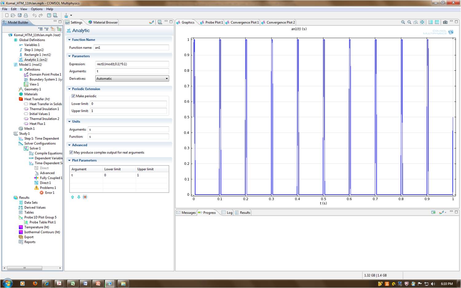

Posted: 1 decade ago Jan 11, 2011, 8:46 p.m. EST
Hi Ivar,
Back again with the similar problem. Apologies for the same since I am a new user of COMSOL.
I've attached 2 snapshots, showing the input of rect1 and an1.
an1: rect1(mod(t[1/ms],20))
Could you please guide me where am I going wrong?
Hitesh
Hi Ivar, Back again with the similar problem. Apologies for the same since I am a new user of COMSOL. I've attached 2 snapshots, showing the input of rect1 and an1. an1: rect1(mod(t[1/ms],20)) Could you please guide me where am I going wrong? Hitesh
Posted: 1 decade ago Jan 12, 2011, 1:57 a.m. EST
you must better study the "rect() (and step() its similar, just a "half" rectangle):
You should NOT use fully rectangular pulses, because the steps does not allow to define any gradients or derivatives at the step, and the solver needs the first derivative to find its way in an efficient way. Therefore you should leave the "step" rise time just make it reasonably short enough (that was the issue of the Heaviside functions too), I left it at 0.1, as I was inputing my values of time in ms, this means 100 usec, which is reasonably short (you may change)
Note: when I write t[1/ms], this means that the resulting value pushed to the function is 1000*t with T in seconds, therefore the modulo 20 as this is now modulo 20 msec
then you should note that the rect() function start with this smooth step such that we are midway at t=0. Therefore I added half the step rise time to the "lower value=0.05", to have the step starting really at "0" for t=0. the duration is then your 0.5 msec + half the rise time from the start = 0.55 (Upper limit)
So I see I confused you with my units in [ms], so you can also write:
rect1() with Lower limit = 0.05*1E-3, Upper limit =0.55*1E-3, size of transition =0.1*1E-3, and then call it with a
rect1(mod(t[1/s],20E-3))
or if you want to reduce the step rise time you corredct also the other values such as:
Final comment: the reason why the step function is not aligned at "0" for t=0, but start the ramp before, is also that when the solver initiates the calculations of the signal and it's derivative they are not both at "0". Such "flat initial" conditions can mislead the solver

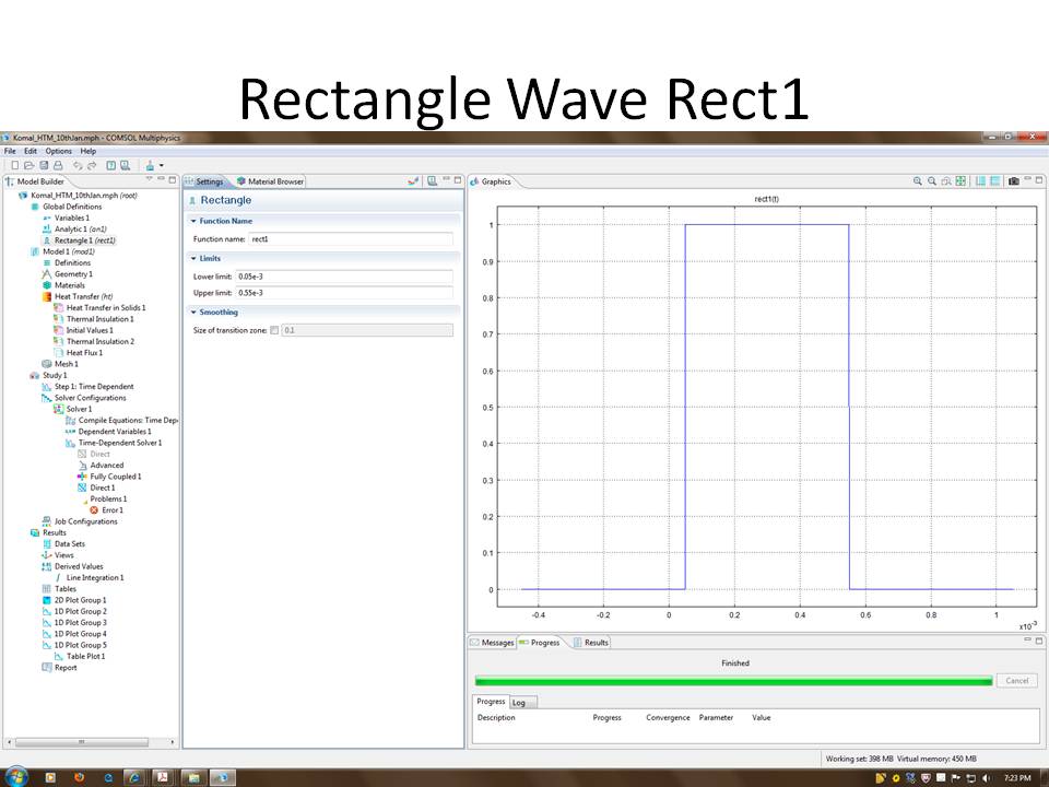

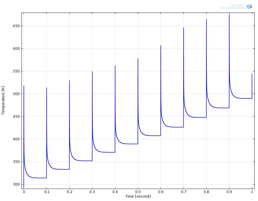

Posted: 1 decade ago Jun 17, 2011, 7:29 p.m. EDT
Dear Ivar:
I'm currently struck with the problem to define a function for laser pulse train , which is not getting solved, may be it just a small silly mistake, but it holding back from my actual results.
for my pulse train, Pulse width = 5e-4 sec, frequency = 10Hz, period = 0.1 sec
I'm defining rectangle function in comsol-v4.2,
rect1() with Lower limit = 5e-4, Upper limit =5.5e-4, size of transition =0.1e-4, pic attached
rect1(mod(t[1/s],0.1)*0.1)
I can able to plot the function in analytic function and I attached the picture for the same.
In my heat transfer model, Heat flux = avg_pd * rect1(mod(t[1/s],0.1)*0.1)
Time-dependent solver = study setting = time = range(0,1e-4,1)
After solving this study, I can see that my output is not correct and only gives me single pulse.(pic attached).
Please help me to resolve this problem.
Your reply is highly appreciated.
Hitesh Vora

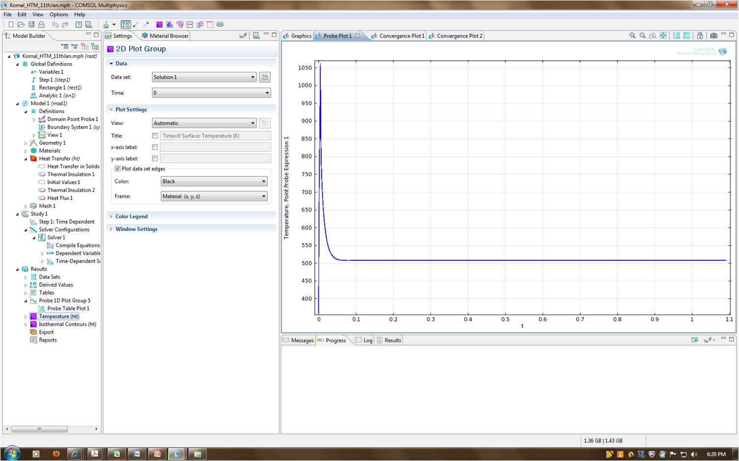

Dear Ivar: I'm currently struck with the problem to define a function for laser pulse train , which is not getting solved, may be it just a small silly mistake, but it holding back from my actual results. for my pulse train, Pulse width = 5e-4 sec, frequency = 10Hz, period = 0.1 sec I'm defining rectangle function in comsol-v4.2, rect1() with Lower limit = 5e-4, Upper limit =5.5e-4, size of transition =0.1e-4, pic attached and then call it with a rect1(mod(t[1/s],0.1)*0.1) I can able to plot the function in analytic function and I attached the picture for the same. In my heat transfer model, Heat flux = avg_pd * rect1(mod(t[1/s],0.1)*0.1) Time-dependent solver = study setting = time = range(0,1e-4,1) After solving this study, I can see that my output is not correct and only gives me single pulse.(pic attached). Regards, Please help me to resolve this problem. Your reply is highly appreciated. Hitesh Vora
Posted: 1 decade ago Jun 18, 2011, 2:55 a.m. EDT
Hi ---- Good luck Ivar
Posted: 1 decade ago Jun 18, 2011, 4:11 p.m. EDT
Dear Ivar,
Thanks for the prompt reply!!!!
I tried to use the suggestion given on January 12, 2011 (reply) and also tried to implement different suggestion on the Comsol Forum , but I havenot achieved desired result.
I am attaching my model for reference.
My problem is : Even if I get the pulse train of frequecy 20Hz and pulse width 0.5 ms, which I can plot on analytic function, but my output remains ON only for the first pulse and rest is OFF.
Please suggest me some solution. Apologies for asking the same problem over and over.
Hitesh
Dear Ivar, Thanks for the prompt reply!!!! I tried to use the suggestion given on January 12, 2011 (reply) and also tried to implement different suggestion on the Comsol Forum , but I havenot achieved desired result. I am attaching my model for reference. My problem is : Even if I get the pulse train of frequecy 20Hz and pulse width 0.5 ms, which I can plot on analytic function, but my output remains ON only for the first pulse and rest is OFF. Please suggest me some solution. Apologies for asking the same problem over and over. Regards, Hitesh
Posted: 1 decade ago Jun 25, 2011, 3:35 p.m. EDT
Dear Ivar:
Fianlly Got it!
I found where am I wrong, I didn't select "strick" time stepping in time dependent solver.
Above all the function working good after selecting "Strick" time stepping.
Thanks a lot Ivar !
Hitesh
Dear Ivar: Fianlly Got it! I found where am I wrong, I didn't select "strick" time stepping in time dependent solver. Above all the function working good after selecting "Strick" time stepping. Thanks a lot Ivar ! Hitesh

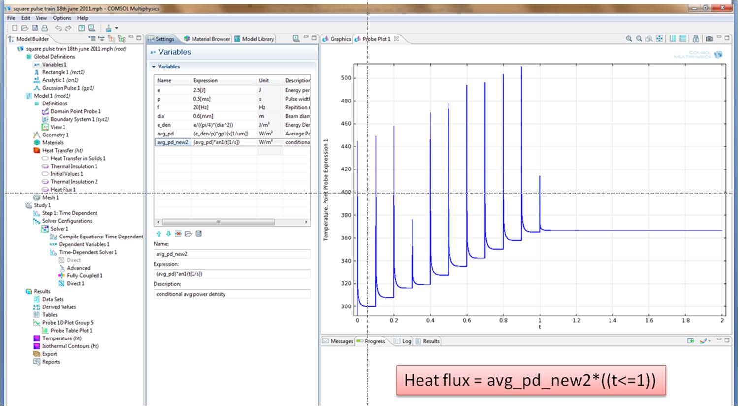

Posted: 1 decade ago Jun 27, 2011, 3:39 p.m. EDT
Dear ivar:
I need my pulse train to be operative for first 1sec, i.e. heat on for 1sec in 10 pulsed per 0.1 period, and after that cooling in air. I'm trying to implement this condition by appling following equation.
Heat flux = avg_pd_new2*((t<=1))
where,
e 2.5[J] Energy per pulse
p 0.5[ms] Pulse width
f 10[Hz] Repitition rate
dia 0.6[mm] Beam diameter
e_den e/((pi/4)*(dia^2)) Energy Density
avg_pd (e_den/p)*gp1(x[1/um]) Average Power Density with guassian beam
avg_pd_new2 (avg_pd)*an1(t[1/s]) conditional avg power density
My problem: after applying above condition, the heat is still ON after 1sec, and temp is constant 366[k], which is not right and temp should be reduced further more.
I unable to find any solution for this problem, can you pls help me on this!
Model and image are attached.
Hitesh
Dear ivar: I need my pulse train to be operative for first 1sec, i.e. heat on for 1sec in 10 pulsed per 0.1 period, and after that cooling in air. I'm trying to implement this condition by appling following equation. Heat flux = avg_pd_new2*((t
Posted: 1 decade ago Oct 6, 2013, 3:44 a.m. EDT
Hi Hitesh,
I was wondering did you figure out how to cool the lattice in between pulses? I am having the same problem whereby the temperature remains constant in between pulses. I am currently trying to model the two temperature model on multiple femtosecond pulses.
Thank you kindly for your time,
Clare
Hi Hitesh, I was wondering did you figure out how to cool the lattice in between pulses? I am having the same problem whereby the temperature remains constant in between pulses. I am currently trying to model the two temperature model on multiple femtosecond pulses. Thank you kindly for your time, Clare
Posted: 1 decade ago Oct 6, 2013, 5:06 a.m. EDT
Hi, Clare,
Hitesh had set ALL the rest of boundaries (different to that of input flux) to "Thermal Insulation". Surely he mistook the node "Thermal Insulation 2" and he intended to cool the piece with, for instance, a typical "Convective Heat Flux" with some positive value for h. Obviously his piece had no opportunity to cool, simply the heat couldn't get out!
And as periodic pulse he uses the analytic function "an1" with expression "rect1(mod(t[1/s],0.1))", but he ALSO sets this function as periodic: one of both is enough, or else he sets as periodic or he uses "mod()". So he could have used simply as expression for an1: "rect1(t)"and as period 0.1
Jesus.
Hi, Clare, Hitesh had set ALL the rest of boundaries (different to that of input flux) to "Thermal Insulation". Surely he mistook the node "Thermal Insulation 2" and he intended to cool the piece with, for instance, a typical "Convective Heat Flux" with some positive value for h. Obviously his piece had no opportunity to cool, simply the heat couldn't get out! And as periodic pulse he uses the analytic function "an1" with expression "rect1(mod(t[1/s],0.1))", but he ALSO sets this function as periodic: one of both is enough, or else he sets as periodic or he uses "mod()". So he could have used simply as expression for an1: "rect1(t)"and as period 0.1 Regards, Jesus.

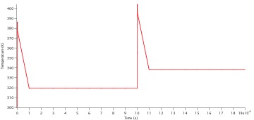

Posted: 1 decade ago Oct 16, 2013, 6:27 a.m. EDT
Thank you Jesus for your reply.
I am using a PDE model not a heat transfer model as I need to use the two-temperature model for femtosecond pulses so the heat transfer model does not apply.
For multiple pulses I use the equation:
flc2hs(mod(t,10e-6)-1e-15,1e-15)-flc2hs(mod(t,10e-6)-500e-15,1e-15)
where there is a 500 fs pulse occurring every 10e-6 seconds.
I multiply this by the source term.
My time range is:
range(0,1e-15,10e-12),range(10e-12,1e-6,10e-6),range(10e-6,1e-15,0.0000100000005),range(0.0000100000005,1e-6,20e-6)
I have attached on a picture of how the lattice is produced. As you can see the lattice temperature is not cooling down to room temperature. Would you have any ideas why this is occurring?
Clare
Thank you Jesus for your reply. I am using a PDE model not a heat transfer model as I need to use the two-temperature model for femtosecond pulses so the heat transfer model does not apply. For multiple pulses I use the equation: flc2hs(mod(t,10e-6)-1e-15,1e-15)-flc2hs(mod(t,10e-6)-500e-15,1e-15) where there is a 500 fs pulse occurring every 10e-6 seconds. I multiply this by the source term. My time range is: range(0,1e-15,10e-12),range(10e-12,1e-6,10e-6),range(10e-6,1e-15,0.0000100000005),range(0.0000100000005,1e-6,20e-6) I have attached on a picture of how the lattice is produced. As you can see the lattice temperature is not cooling down to room temperature. Would you have any ideas why this is occurring? Thank you kindly for your time, Clare
Posted: 1 decade ago Oct 16, 2013, 7:05 a.m. EDT
Do you include some Neumann bound. condition with non-zero flux (of course, for cooling flux must go out) or some Dirichlet bound. condition with some not-very-high temperature? If you have some of them, temperature should not get stuck, but drop slowly. You can upload your file for us to take a look and see what happens.
Jesus.
Hi, Do you include some Neumann bound. condition with non-zero flux (of course, for cooling flux must go out) or some Dirichlet bound. condition with some not-very-high temperature? If you have some of them, temperature should not get stuck, but drop slowly. You can upload your file for us to take a look and see what happens. Regards, Jesus.

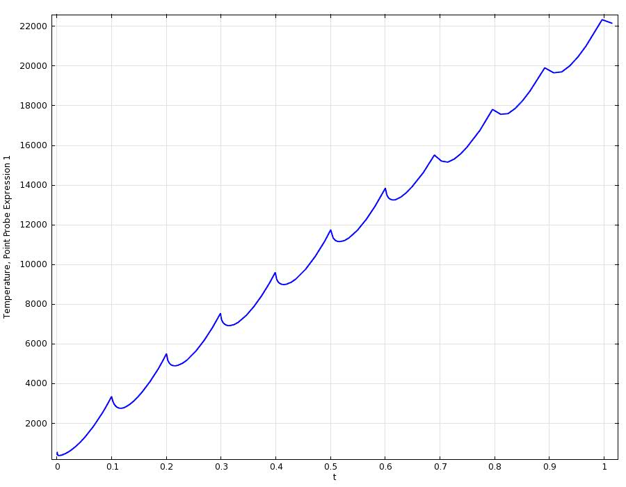

Posted: 1 decade ago Dec 27, 2013, 5:15 p.m. EST
Hi Ivar,
I used analytic function to define a train of pulses
I wrote the expression as : flc2hs(mod(t,0.5)-1E-3,1E-3)-flc2hs(mod(t,0.5)-20E-3,1E-3)
where the pulse width=20 ms, and the frequency of pulses(pps) = 2 HZ
I want to put this train of pulses as a input voltage on a electrode, so i put it input in electric currents> electric potential as v0= an1(t[1/s])
but the problem when i plot the output electric potential on the electrode vs time, I found the output one pulse only not a train of pulses.
could you please tell me what is wrong in it
thanks
Hi Ivar, I used analytic function to define a train of pulses I wrote the expression as : flc2hs(mod(t,0.5)-1E-3,1E-3)-flc2hs(mod(t,0.5)-20E-3,1E-3) where the pulse width=20 ms, and the frequency of pulses(pps) = 2 HZ I want to put this train of pulses as a input voltage on a electrode, so i put it input in electric currents> electric potential as v0= an1(t[1/s]) but the problem when i plot the output electric potential on the electrode vs time, I found the output one pulse only not a train of pulses. could you please tell me what is wrong in it thanks
