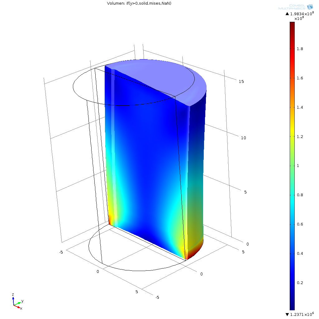

you can define a 3D plot with volume and define your cut plane inside plot definition.
For example: if(y>0,solid.mises,NaN)
This will plot only elements with y>0. See attached example.
Ralf
