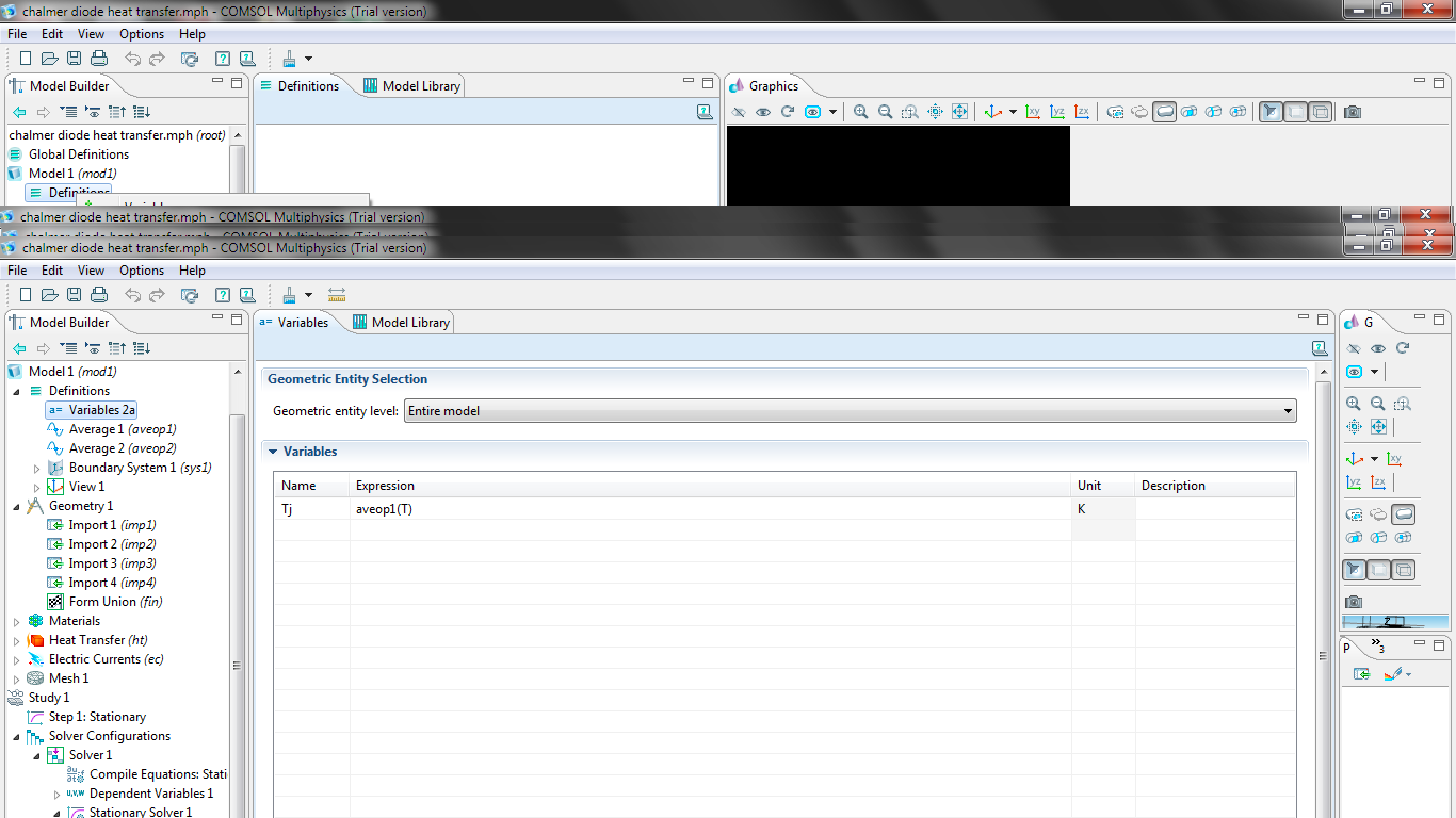

the dependent variables are fields (that is they are T(x,y,z,t ...)) so if you write T the rest is implicit nad its the local temperature that applies to the dx*dy*dz element.
You can always define a global MyT as aveop1(T) over some domain or oundary nad decide to link some of your dependences on "T" to MyT, then you force the same scalar value MyT to all elements defined
Hi the dependent variables are fields (that is they are T(x,y,z,t ...)) so if you write T the rest is implicit nad its the local temperature that applies to the dx*dy*dz element. You can always define a global MyT as aveop1(T) over some domain or oundary nad decide to link some of your dependences on "T" to MyT, then you force the same scalar value MyT to all elements defined -- Good luck Ivar

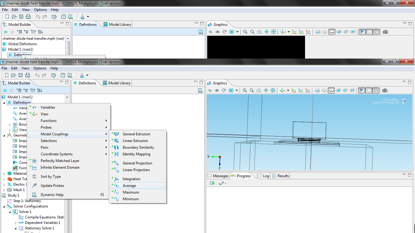

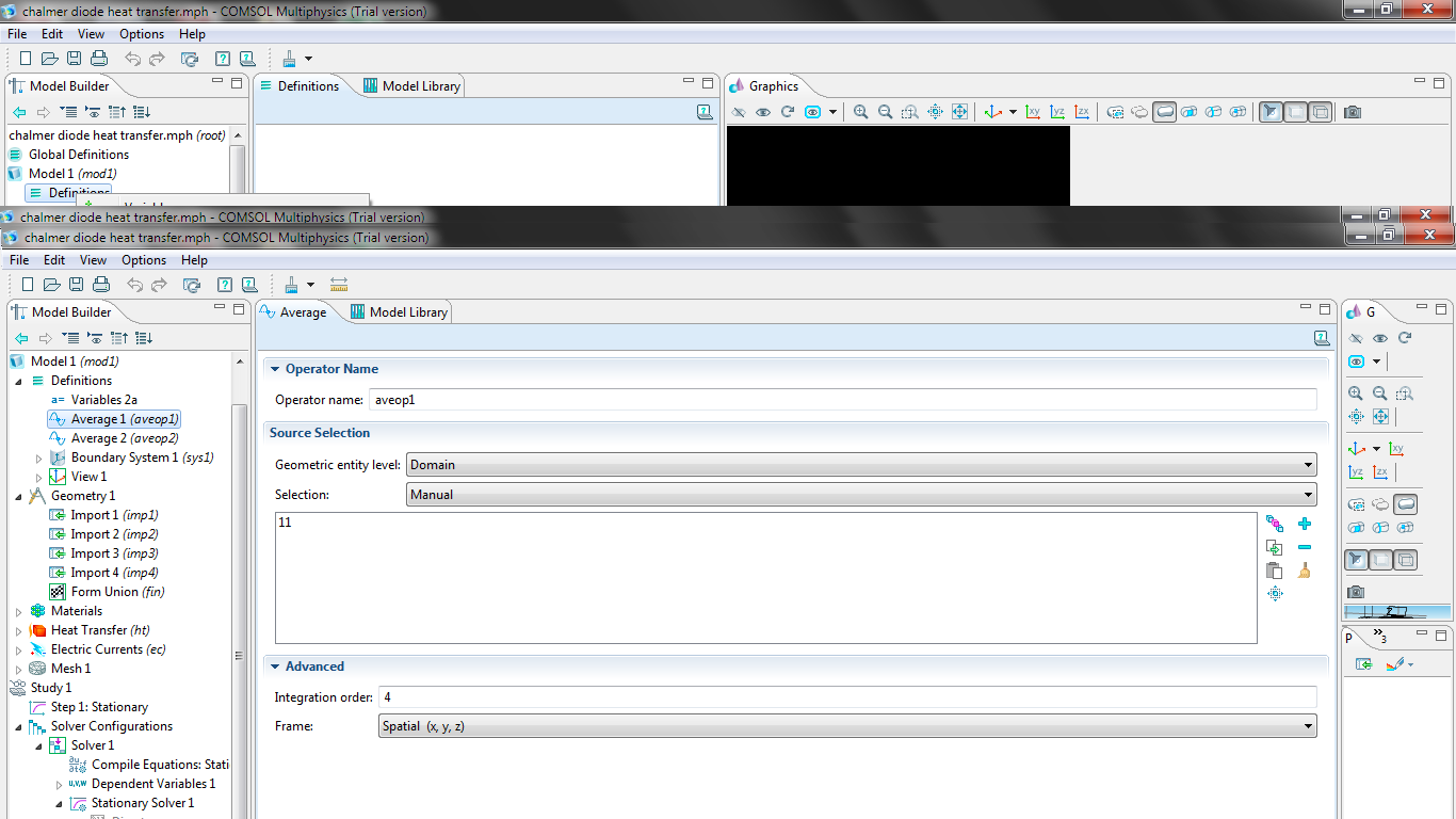

sorry for the late reply Oscar. I was away. I took Ivar's suggestion. I defined a paramemter MyT and then model coupling and average. select the domain. The average variable name is aveop1. Then use a variable with the name like T_m as aveop1(T). hope it works for you.
BR,
Arif
sorry for the late reply Oscar. I was away. I took Ivar's suggestion. I defined a paramemter MyT and then model coupling and average. select the domain. The average variable name is aveop1. Then use a variable with the name like T_m as aveop1(T). hope it works for you. BR, Arif
Posted: 1 decade ago Jul 9, 2012, 10:04 a.m. EDT
so, for example, if I want the average of the concentration in a domain, I go to Detinitions-Model Couplings-Average, I choose the domain and then in the operator name, I write:
aveop1(c), but then it says
"Invalid property value
-Property: opname "Operator name" is a string. Must be a valid variable name"
Any idea what is happening?
Hi, so, for example, if I want the average of the concentration in a domain, I go to Detinitions-Model Couplings-Average, I choose the domain and then in the operator name, I write: aveop1(c), but then it says "Invalid property value -Property: opname "Operator name" is a string. Must be a valid variable name" Any idea what is happening?

I think I got it, first I just simply define the average operation, I create aveop1 selecting my domain.
Then I create a variable for that specific domain, for example:
c aveop1(c1)
and now I can have all my properties in function of the average concentration "c" , like
rho (density)=(1+0.00934*c)*(A+B+C)
Am I right??
Hi, Yeah, c is the dependant variable. I am using the transport of diluted species of the Chemical Reaction library. I think I got it, first I just simply define the average operation, I create aveop1 selecting my domain. Then I create a variable for that specific domain, for example: c aveop1(c1) and now I can have all my properties in function of the average concentration "c" , like rho (density)=(1+0.00934*c)*(A+B+C) Am I right??
Posted: 1 decade ago Jul 9, 2012, 10:15 a.m. EDT
I cannot explain myself that well. maybe this will help
Posted: 1 decade ago Jul 9, 2012, 10:17 a.m. EDT
can you change the name of the variable and then try c to lets say c_a ..everything in my opinion looks fine.. but i am new to comsol.. using it for 3-4 months
br,
arif
can you change the name of the variable and then try c to lets say c_a ..everything in my opinion looks fine.. but i am new to comsol.. using it for 3-4 months br, arif
Posted: 1 decade ago Jul 9, 2012, 10:18 a.m. EDT
Yeah,
that was exaclty what I tried to write. I think it is working now. Thank you very much for your help.
See you,
Oscar
