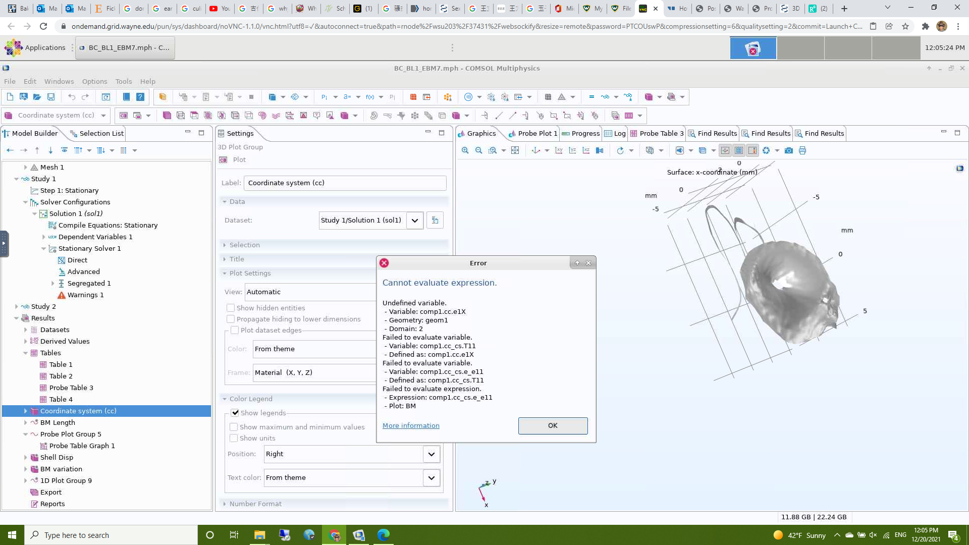

Because I wanted to get the pressure in addition to the original results, I added a new surface probe and set the expression as "p". An error jumped out, which said I have an undefined variable. The variable is the e1X value of the coordinate system. I am confused because I think adding a probe should not change andy physic or definition. How could this happen?

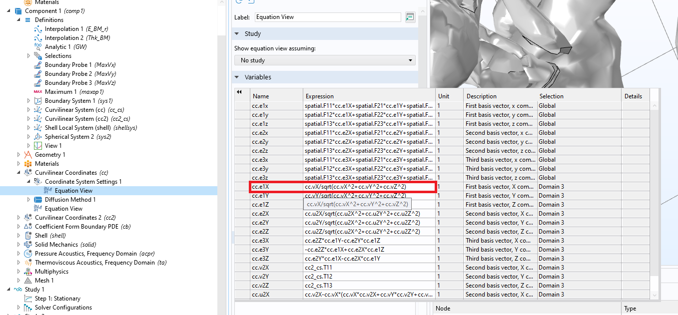

I did try both "compute" and "update solution" in the setting of the "study1" node. That was where the error came out. I then search for the "comp1.cc.e1X". I did find the definition under the curvilinear coordinate node (see the attachment).
I am comfused about the way COMSOL compile the nodes. Is there any way to debug the settings?
I did try both "compute" and "update solution" in the setting of the "study1" node. That was where the error came out. I then search for the "comp1.cc.e1X". I did find the definition under the curvilinear coordinate node (see the attachment). I am comfused about the way COMSOL compile the nodes. Is there any way to debug the settings?
