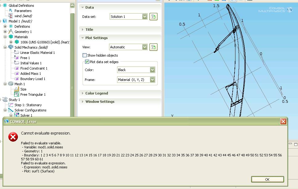

I am trying to run a static analysis on Comsol 4.3, on a wind turbine blade.
I have fixed constrains and apply force, but I have this error message.

I would usggest that you check your material properties, some either they (or some) are missing, or something is wrongly coupled

It looks like a post-processing plotting error. Did the Study Step converge?

There is no solution, because I have directly this error message.

now I notice a specific word in there : "boundary" !
Normally one define the material properties on domains, these are not propagated to boundaries, so as Nagi is stating you are probably asking for something in the postprocessing on Boundries that is not defined,

When I try to apply boundary on the model, it is write (not applicable).
So certainly the problem is from that.... is my geometry wrong ?

it could be but perhaps its the mesh, you model looks like a 3D geoemtry, but looking closer I see only a 2D tri mesh, and not a 3D thet mesh. normally you should have a warning "not all domains meshed" and as you have defined the material properties on the domain (I suppose) the boundaries are not defined (nd probably shoul neither not be ;) but with a surface mesh you will get such erors, not all obvious to debug.
Hope it's this ;), try adding a thet mesh node, or use a default physics mesh

Is there the problem from: union or assembly in the geometry ?
I need a static analysis, and apply fixed constrains and boundary load...

no I believe frst you should check the MESH, you need a 3D thet mesh on the domains and not ONLY a 2D tri mesh (of boundaries)
