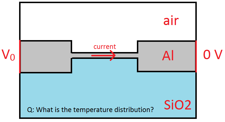

I am trying to do the simple task of drawing a 2D metal rectangle embedded in some dielectric, pass a current through, and plot the temperature distribution due to heating (which will be hottest where the bar is narrowest).
I have attached a file with a 2D metal bar between. I am getting the error "Singular matrix. There are 1806 void equations (empty rows in matrix) for the variable mod1.V...."\
Not sure why I'm getting this.

Conductivity for all domains was given through the Material Browser (where I got the materials). The only thing Material Browser didn't give me was "relative permittivity" for Al.
I thought it might be helpful to attach an image of what I'm trying to simulate. It is really a simple structure, just trying to find What is the temperature distribution in a thin Al sheet sandwiched between SiO2 and air, in a 2D (cross-sectional) format.

for the materials, the material data base might give you values, but these do not mean they are "correct" for a given physics. If you are solving for the Voltage V (i.e. MEF physics) you must have some NON-zero conductivity, even if the default of the material is "0". So if you have some "air" or water, try to set a conductivity of 1 S/m
That did it! Thanks! Would be good to have a more helpful error message which would see if you set conductivity to zero and just warn you.
