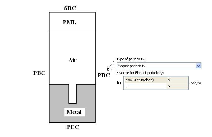

I set left-right boundary as periodic boundary condition with Floquet periodicity (the related setting as well as other boundary conditions see Structure. JPG);

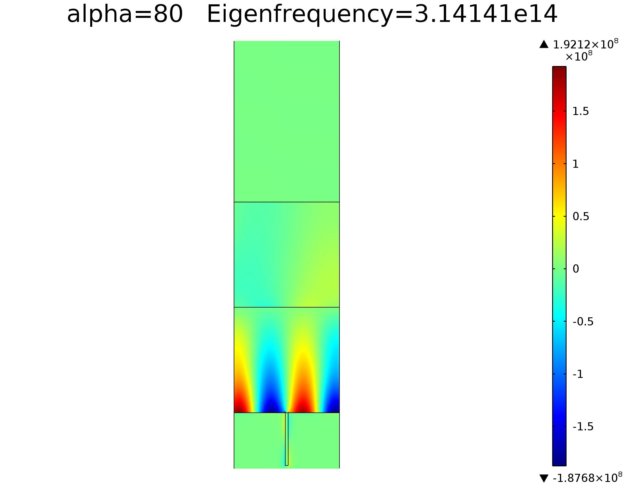

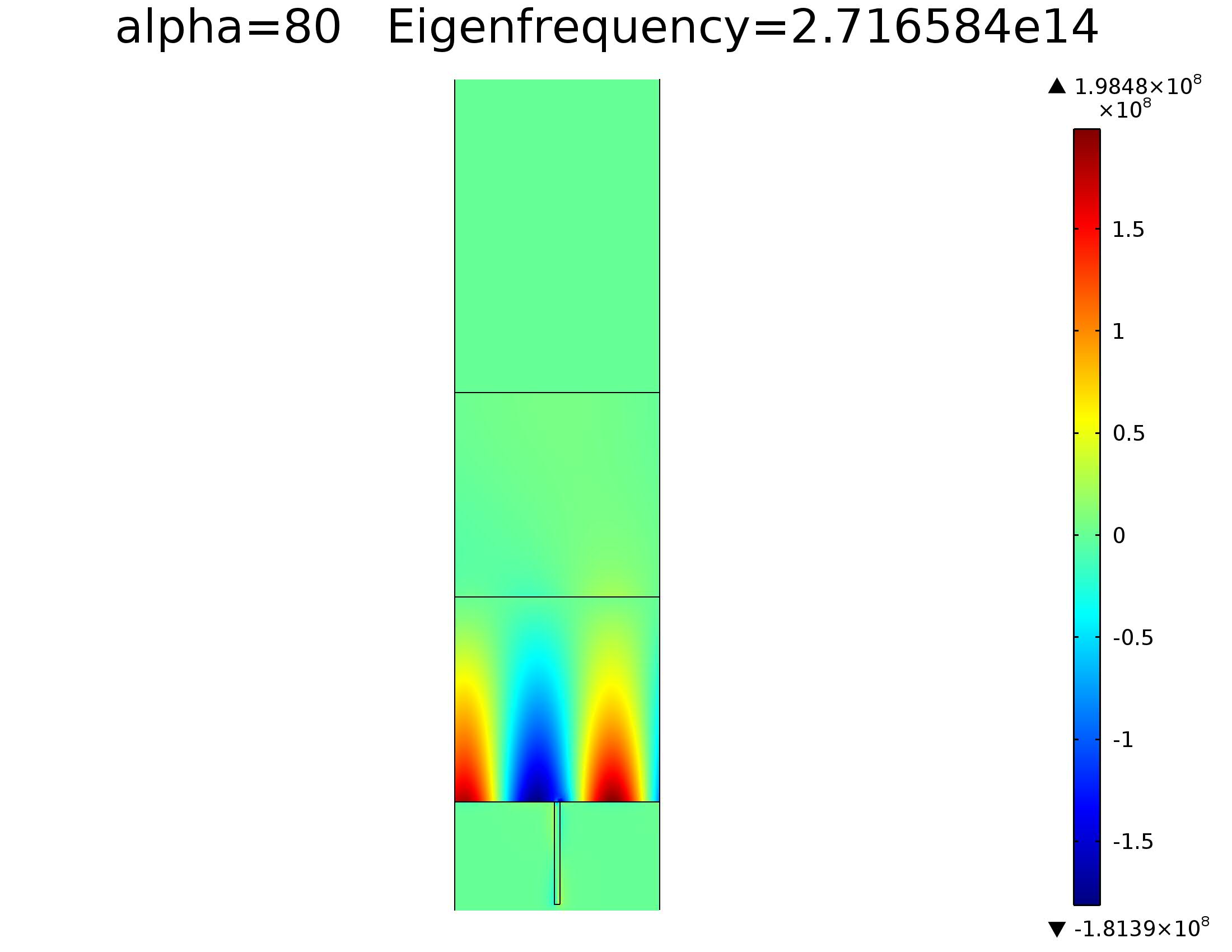

Here giving an example, when alpha is set as 80 degree, then the related eigenfrequency of surface plasmon mode is analyzed, the corresponding field distributions are see attached (a.jpg and b.jpg).
From the distributions, we can see that they are indeed the surface plasmon wave supported by the structure.
Then the dispersion relationship can be obtained simply based on these eigenfrequency values.
Above is my thought about the model.
Is it reasonable? If not, anybody could give me some suggestions?

I'd include PML on the bottom as well. Other than that, everything seems fine.

Actually, when the dimension of PML changes, the eigenfrequency changes as well, it is unreasonable.
Hi, Alexander, Thanks for your reply. Actually, when the dimension of PML changes, the eigenfrequency changes as well, it is unreasonable.
Posted: 1 decade ago Aug 10, 2012, 3:26 a.m. EDT
perhaps you PML is not 100% then, reflecting back energy, or it's too close to the grating
Hi perhaps you PML is not 100% then, reflecting back energy, or it's too close to the grating -- Good luck Ivar

Yeah the reason is that PML is close to the structure.
Yet, maybe my thought is not right, the dispersion relationship of surface plasmon wave is wrong.
I am so stuck with this model i.e. how to get the dispersion curve of surface plasmon wave that propagates along the metal grating.

another point that strikes me is that the field response is not periodic, but looks more antiperiodic w.r.t. left-right F boundaries, or have I missed a point ?
Hi another point that strikes me is that the field response is not periodic, but looks more antiperiodic w.r.t. left-right F boundaries, or have I missed a point ? -- Good luck Ivar

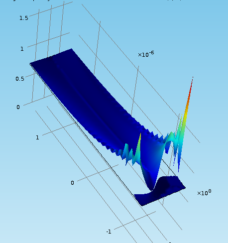

Can you explain in some detail how you set up that PML at the top? I'm performing a very similar simulation with a dielectric waveguide at the bottom rather than the SP waveguide and I can't figure out how to set up the PML. I've attached a screenshot that shows the upper portion of my air domain on top of the unit cell and the PML at the top. The magnetic field of one of the eigenfreq solutions is shown in the attached image. It appears as though the boundary between the PML and the air is just a PEC.
How did you define the boundaries? Is meshing important? Do you generally have to provide any inputs, or do you just add the domain, designate it PML and solve (it seems that's all they do in the tutorials)?
Any advice would be appreciated, thanks.
Chris
