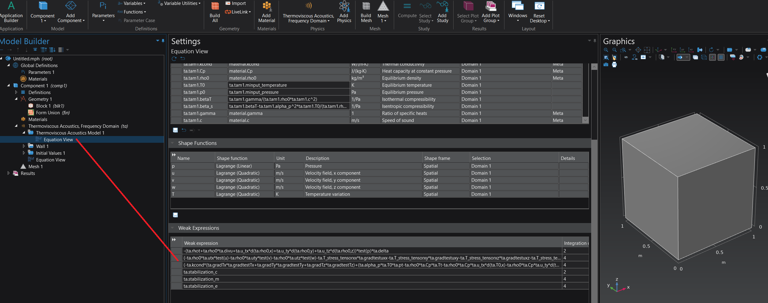

Briefly, i'm designing a hydrogen storage tank, which has porous metal hydride bed inside.
For the momentum conservation at the porous area, I need to use the given equation below.
It seems that physics interface of "Brinkman Equation" gives a similar form of Navier-stokes equation. However, I need to remove a certain term as I marked in the image below so that the equation to be exactly same shown above.
I am aware of the "Equation View" option, but still got stuck... or shall I use the equation-based modelling such as Mathematics physics interface?
