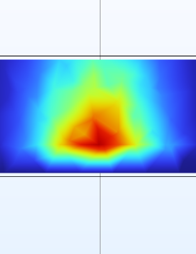

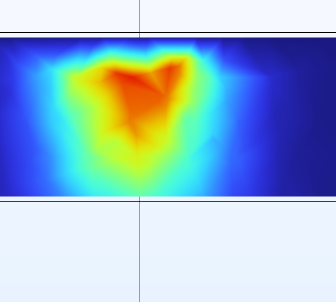

I have 2 slice plots plotting 2 different data on the same plane within the same plot group. I want to see how the data overlaps. However, it only shows the last one within the plot group. So if either slice 1 or slice 2 (in image attached) is the first one in the plot group, the data isnt seen, although on the side there is a color bar for it. I would expect to see a blend of the data.
Is there a way to solve this?
Each slice plots an expression. Is there a way to have the two expressions in one plot? That's another way i can consider going about this. Thank you Eddy!

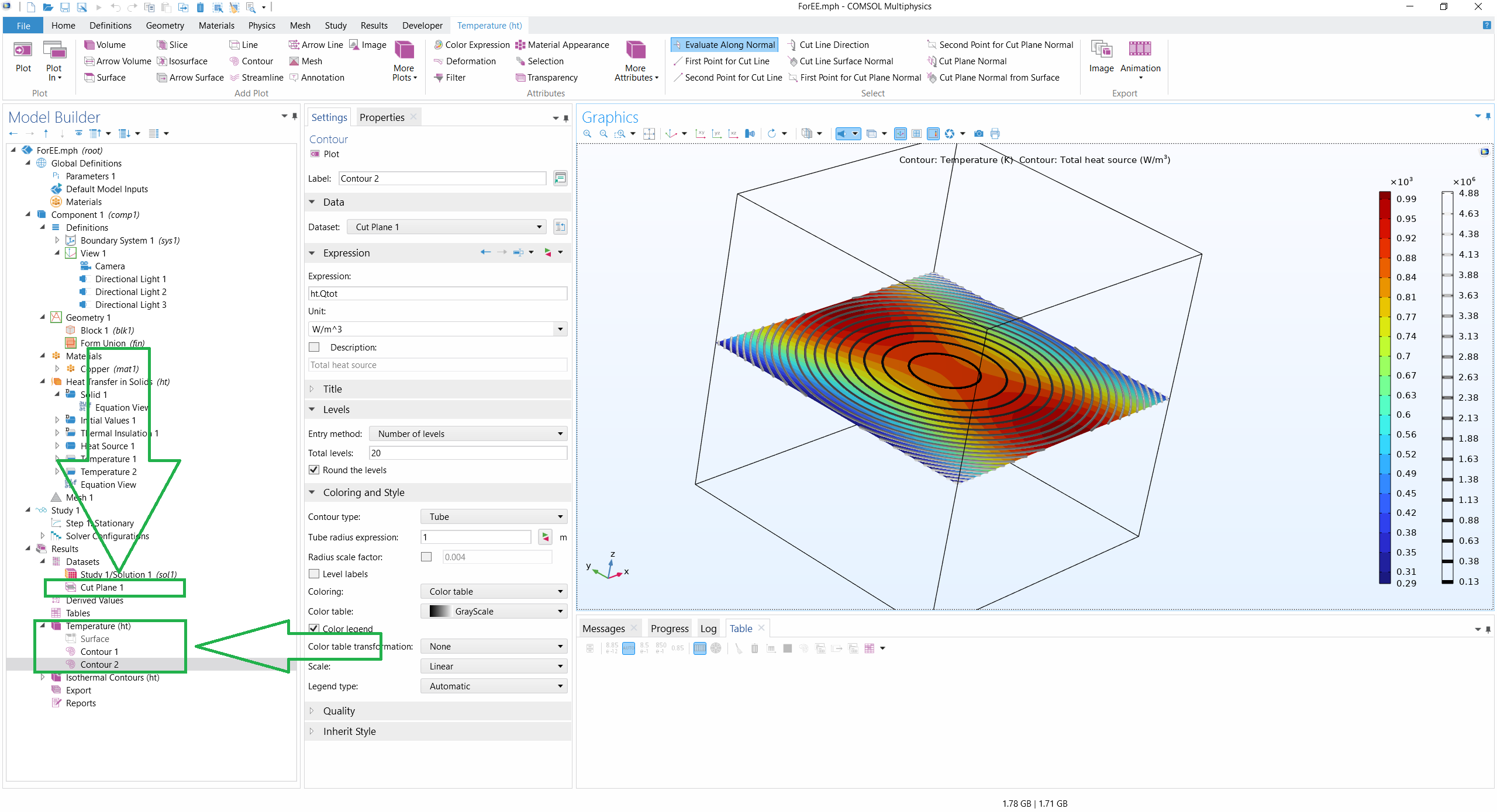

Hello Edidiong,
See the attached file: I use two contour plots (with different color schemes) defined on Cut Plane 1, which is a data set I added. You can play with the "Contour Type" settings to make each contour plot more to your liking. Here I am using "Filled" and "Tubes", but you can also choose "Lines" (that's the default).
